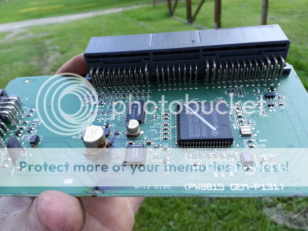

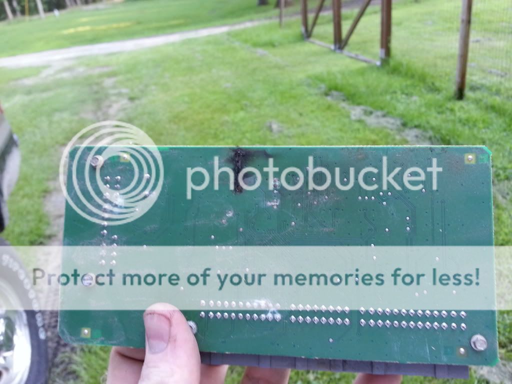

Ya Id say your is toasted there pungohboy. Ive saw them look like that before but not that bad. I bet ya smelled a bit of smoke when she went lol. Mine had white carbon tracts threwout so I replaced it and its nice to have everything work as it should. I did a couple of others this year and only one looked burnt like yours and his 4x4 didnt work so that part of it must short pretty good. Id believe these modules are controlling more then they should be. Instead of putting it all in one module maybe they should have atleast had 2 seperate modules.
#16 ·
Are ya getting a new one there pungohboy cause some of the new ones I replaced had to be flashed by the dealer for the specific truck it was going in. I found out the hard way and put a new one in and the first two trucks worked great and the 3rd truck everything worked backwards so the dealer had to reflash it and all was good. I put a good used one in my truck and works great but the other guys wanted new ones. I couldnt see paying $425.00 for the vsm/gem then another $75.00 to have them flash it.
