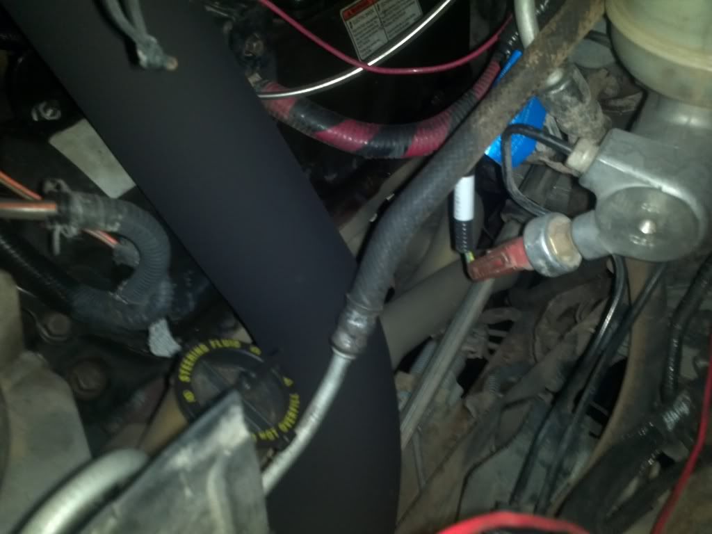

#8 ·
This motor is in an obs, reason it has no sticker is years ago, our ford dealership had a bunch of original 7.3 complete factory motors laying around that my shop bought, and for whatever reason, they didnt get those stickers im talking about, but got that powerstroke sticker
#11 ·
ghohouston, you have to realize that there are quite a few differences between the OBS trucks and 99+ years of trucks and this is one of them.
I have had my truck since new and it never did have that sticker that you speak of.
#16 ·
The date on that sticker makes it a late build August 97 year engine. The late build trucks had some of the e-99 type stuff on them. Check the build date on the truck, its probably tail end production between Sept and Dec. 97. The last OBS diesels were built about mid-December 1997, the e-99 SD commenced production after that.
Oddities include the use of the small SD type engine cover, possibly also the update black intake hose instead of the orange hose to the turbo and the sale of the California splitshot engine in east coast trucks as the factory depleted OBS engine stocks and parts.
My 97 California and 97 Federal engines do not have that sticker, they have the one on the reservoir. thay are both early 97 year engine build dates.
