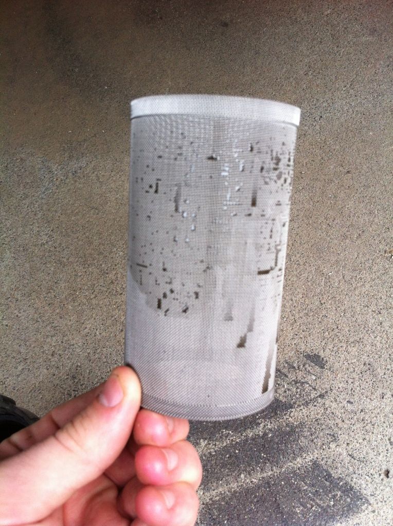

I just used a Polypropylene Line Strainer from Tractor Supply.
What is the point of doing a CCV mod to a catch can, and then turn around a route it back to the intake...!? The point of the CCV mod is to not vent the crankcase into the intake. So you have mod'd the mod to where it is the same as what you had before, except you now have a catch can, to collect a small amount of oil...?
The catch can catches almost all of the oil vapor(you can see this by looking at the picture of it).
That was only after about 600 miles.
id just like to say that even when i start my truck with the first intake pipe removed up to where the ccv joins the intake at it still has smoke/vapor coming out even during warm weather. i do however like that catch can. where'd it come from.
The catch can is from Tractor Supply. The hose came from an auto parts store.
#10 ·
I would assume that there is a significant temp drop thus condensing a fair amount of oil vapor out. Any remaining vapor is probably significantly lower than what is returned to the intake on the factory setup. It would be interesting to measure the amount that you collect over time with the catch can so far from the engine. If i do the mod I will probably do it this way.
