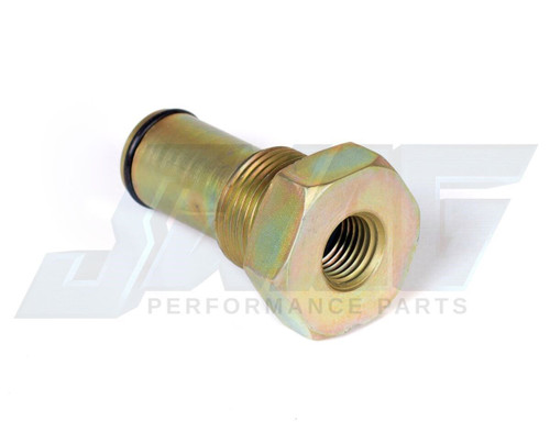

As I said, that does not block the drain hole. You need a special fitting that "mimics" the IPR valve. Note the fitting on the end of the air hose in the video linked below.
Fitting alone:
Cheaper version of fitting:
DTR video:
