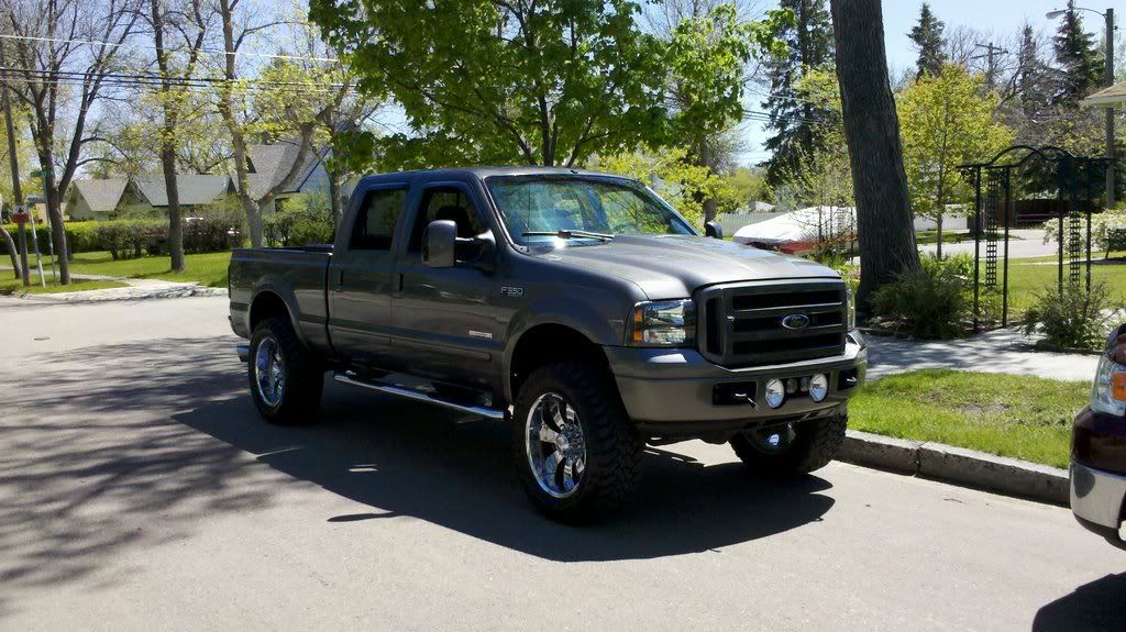

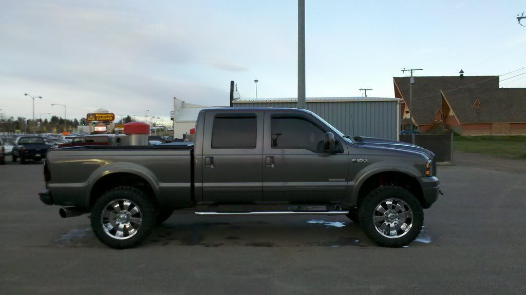

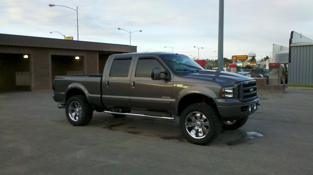

so i got a really GREAT deal on some 37's on 22's and decided i would try them on. I traded some bodywork for these so they really didn't cost me anything. The truck is sitting on only a leveling kit with Rancho shocks. when i first put them on the rubbed the front bumper bad. and the fender liners very minimally. after reshaping the bumper and pulling back the fender liners the wheels and tires fit great and do not even rub the springs. all i need now is a steering stabilizer and I'm set. here's some picks from the other day and some from yesterday. i hope you guys enjoy!!!!

the wheels are 11" wide and the tires are 13.5....... as for the lights i just frenched them in. i made a template. cut out the holes and made a bracket on the inside of the bumper. worked out great
