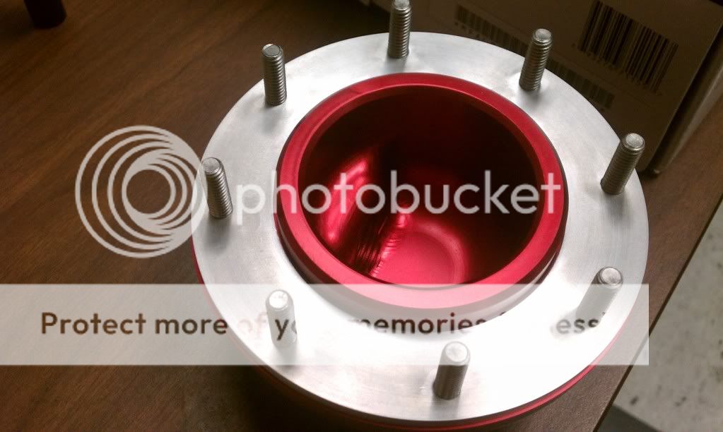

None yet, soon.....studs, egr delete, and regulated return are getting done this coming week and then the following weekend I will start putting the 4wd in. I will post pics and updates as I go. :rockwoot:
