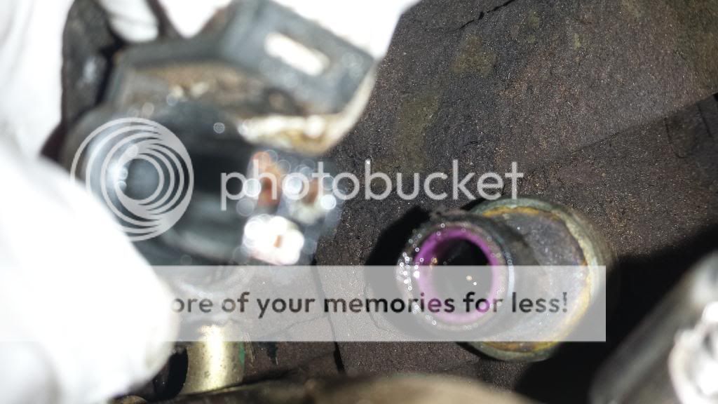

I pulled the ICP connector, it had some oil in it:
I'm not sure if this much oil indicates a bad sensor. Hopefully you guys can fill me in there.

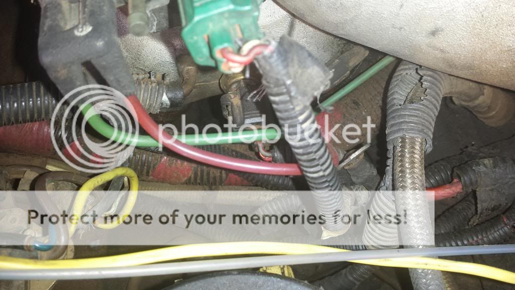

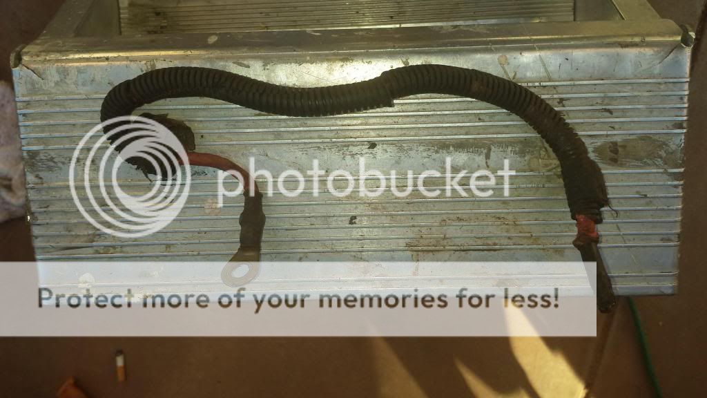

I also found a loose wire in the wiring behind the fuel bowl:mad:. I'm not sure what it goes to, as there aren't any wires missing an end. Hopefully you guys can help me there as well:
You can see the bare terminal in the right side of this pic
The wire pulled right out, and looks like it melted at some point

That wire looks like the one that goes to the intake air heater. I just pulled my CPS to check it the other day and it looked the same, Knock on wood I havent had an issue yet but I'm ordering a new one soon. Really need to see what those codes are.

Replace your ICP sensor with a new FORD sensor. Oil leaching is bad. Will cause all sorts of driveability issues including misses, truck shudder, shutting off. $145 from DieselOrings .

I don't know if it's related, but when I was waiting for the tow truck yesterday I had the truck idling and was checking connections on the engine. I pulled the ICP connector and the idle got worse. Plugged it back in and no change, still worse than before. VC connectors seemed ok, but it wouldn't surprise me if one of the UVCHs is loose. Also, I noticed fuel dripping from the line to the fuel bowl. Is that line supposed to be a hard line? Mine is a hard line
up to about 8" from the fuel bowl, someone put a section of rubber fuel line and hose clamps and thats where it's leaking.
I'm going to replace the ICP, and get some Power Service and see if that helps. I'll recheck the IPR duty cycle and HPOP pressure.
