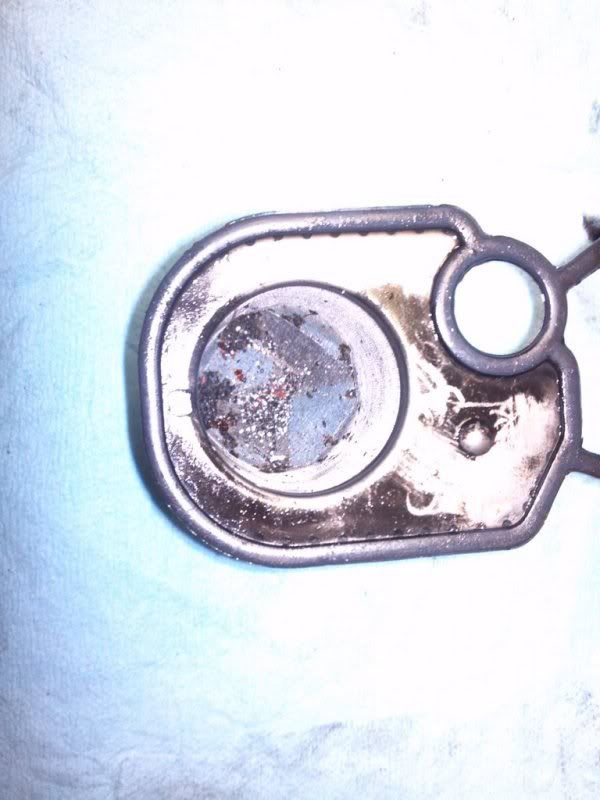

#31 ·
Removed the fuel bowl and HPOP, The screen to the HPOP had some crud in it. Any thoughts on this? I had a turbo go out on me last year, I'm assuming thats where the metal and crud came from. First time the engine has been apart in 176,000 miles. Is it normal to find some stuff on the screen. Here's a picture.
