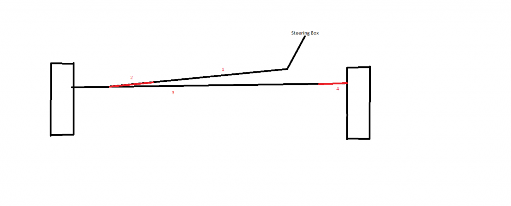

Ive been trying to find OEM part numbers for the steering linkages on my 97 F350 and Microcat is of no help, the diagram does not match what's on my truck.
I'm having a hard time finding the OEM numbers and nomenclature so I can replace it all.
1 and 3 are very long bars.
2 and 4 are connected to the bars by sleeves and threads.
And the microcat image I find is this
My truck does not have a tierod end at the pitman arm like the image shows at 3A131/3304, it's the opposite: tie rod at the othe end, long bar at the pitman arm.

The microcat image is correct, is the top pic showing they welded the draglink to the tie rod? That's what it looks like and that's not how it's supposed to be
FNM
150 Posts
The diagram is correct. Yours is not bone stock: someone swapped the drag linkage.
I would not worry about the factory part numbers. Use all Moog parts and swap everything out.
That's my intention but id like to be able to use the OEM numbers to cross reference, my local parts store is run by Muppets and I'm guaranteed to have to make no less than five visits to get the right parts.
Moog DS1068 tie rod end (drag link)
Moog DS1071 tie rod end (long tie rod)
Moog ES3009R tie rod end (2 required)
Moog ES2012S adjusting sleeve (2 required)
RockAuto usually has the best price on these.

For future reference, the OE Ford numbers are
F2TZ 3A130-B - tie rod end (long tie rod)
F2TZ 3A131-E - tie rod end (drag link)
F2TZ 3304-B - tie rod end (x2)
E7TZ 3281-A - adjusting sleeve (x2).
