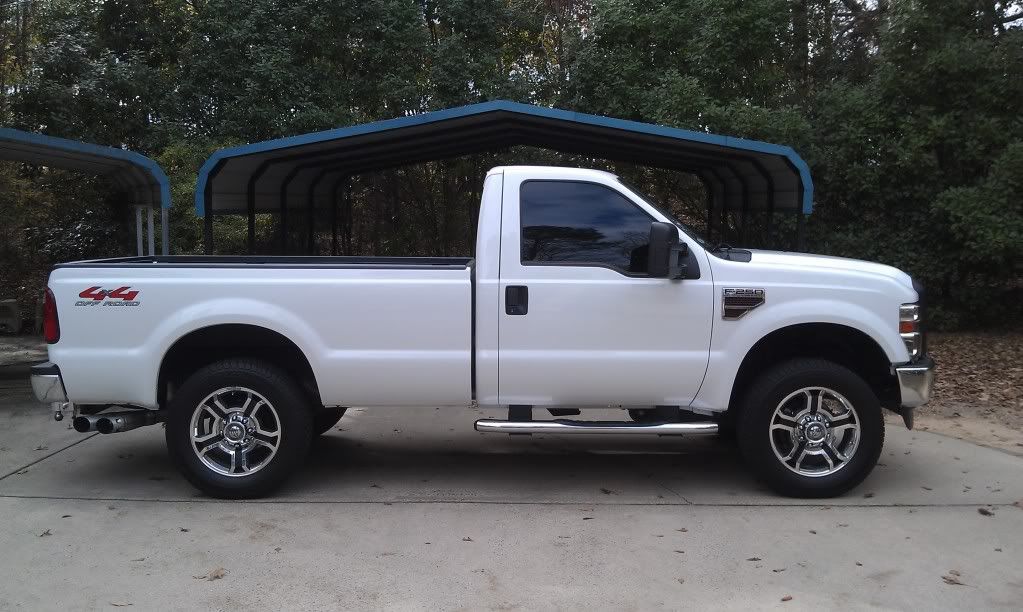

This kit wotks great. Rides like stock. No pulling or alignment issues and sits perfectly level. I also have a extra set brand new in the box that I ordered for a friend and he never picked them up. Pm me if you are interested.
Here is a after pic.
Here is before.

I did keep the factory shocks. I was very surprised at how much extra length they had after I unbolted them and stretched them out. I will also tell you that the brake line bracket bolted right back like factory. Any spacer thicker than 1.5" below the coil and they would not work without modification. Very neat install.

Thanks for the compliments. Jeff it really rides great. I am really picky about the ride and it is no different than stock. Actually handles better with it level.

Ever get the 35's on yet? Did you ever measure front and back to see if it is level. I am considering a 1 inch block or 1.5inch. I do not want the front end higher than the back. I cannot tell in your pick if it is higher in front or not. Looks good

Hey, I have not mounted the 35s yet. Just been putting it off since my buddy mounted his and lost 3mpg and some power. my stock tires still look like new. I have measered mine and front is 41.75" and the rear is 42". My truck sat 1.5" lower in the front factory being a single cab. My 4 door cc sits only 1" lower in the front. They do tend to look level still down a tad bit in the front. I love the feel with the front level now.
Also, I did find that ready lift originally made these spacers in 1" so I got lucky and found a set brand new on e bay for my 4 door. They told me that the demand for 1.5" were higher than the 1".
