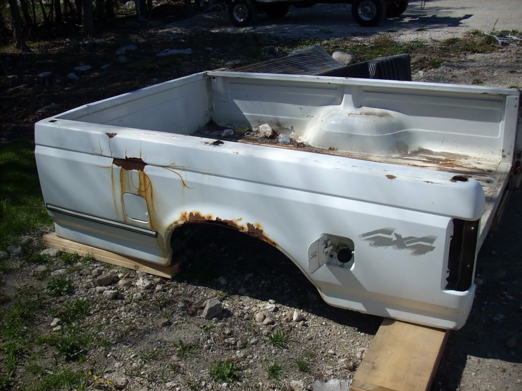

I purchased a the following body parts:
8' box, 2 front fenders, 2 doors. Then it was off to the body shop for a couple months of work. It also required cab corners, sills, and a small portion of the floor being replaced.
