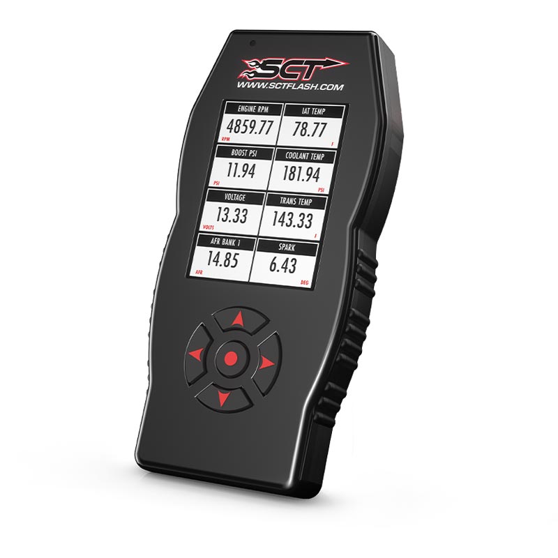

I just put a CTS 3 Insight.....everything I'm readying off that looks great as far as what I've research (pic provided, basic Screen 1 I keep in front of me)
Vehicle Speedometer Trip computer Gauge Odometer
. I have come across more supporting information surrounding a solid tune as opposed to no tune. I still want to do a bit more digging on the tuner I would want.
