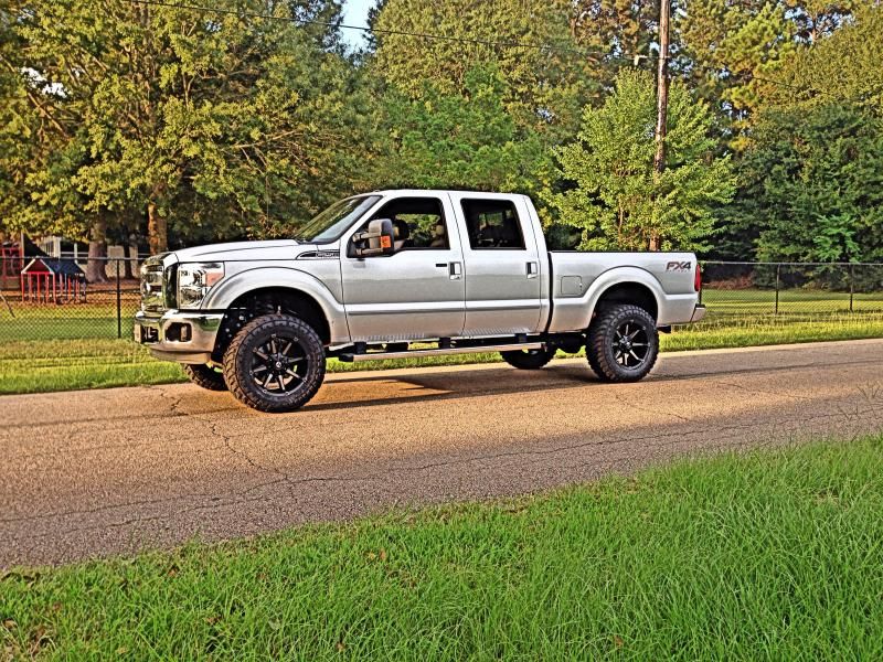

Hey guys,
Well after much going back and forth with the 3 wheels I originally chose for my truck,I ended up findin somthing that was a mix of both the wheels that I liked.I also installed a leveling kit from Newton lifts.Here are the specs of everything:
2.5" leveling spacers up front and 4" blocks in the rear from Newton Lifts
20x10 Fuel couplers -24 offset
35x12.5x20 Amp M/T's
I really like the turnout of the truck and can't wait to add some amp steps to it.

Looks good

Did you install an adjustable track bar? If not can you tell the axle being not centered or is it still? Did you install alignment caster cams? Thanks
Nice,which shocks are you running or you add extenders of some sort?
I installed the spacers for the track bar that came with the Newton kit.Negative on the alignment caster cams.
Charles
I'm just running the shock extenders on the front right now.Im pretty set on the Rancho 9000's tho in a few months if I don't change up this setup.
Charles
I have the rs9000's the adjustability is a novelity item, if you want them they ride decent at 7 up front and 3 in the rear... I would look into the bilstein 5100's also not adjustable but everyone I know that has me loves em
Had the 5100's on my 13 fx4 pos' never ever again,they actually rode worse then stock but looked good lol.
Love the stance of your 15&the wheels on the 6.4 not a fan of black myself it looks good in person but horrible in pics imo,but still love the truck have had 4 ingot silver fords great color.

I really like the stance of your setup, looks good! ! How does the lift ride?
