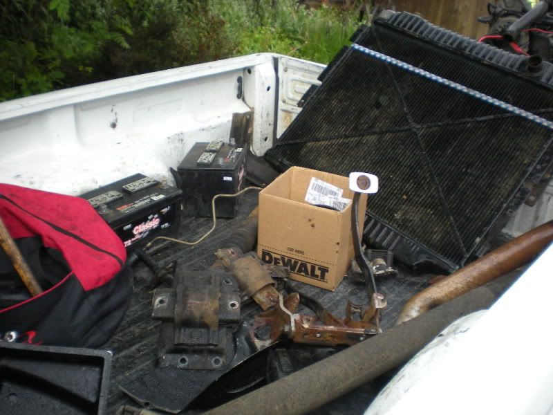

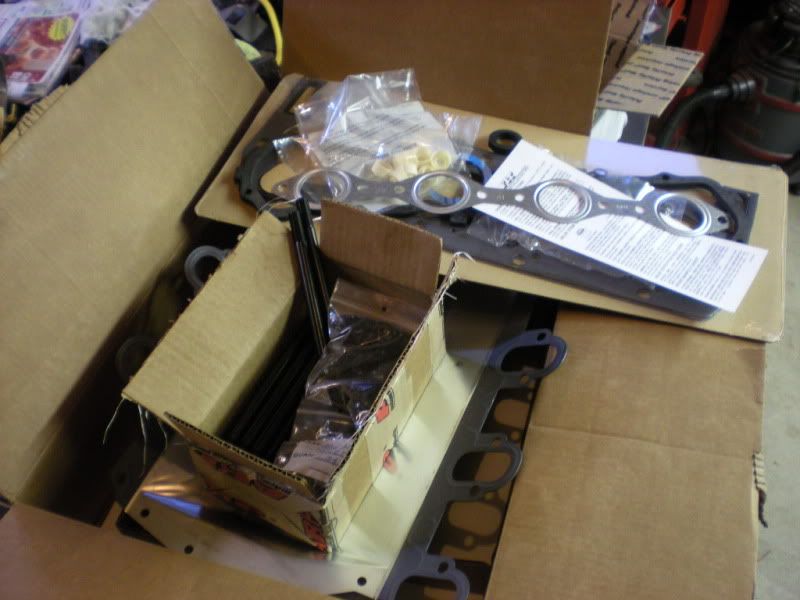

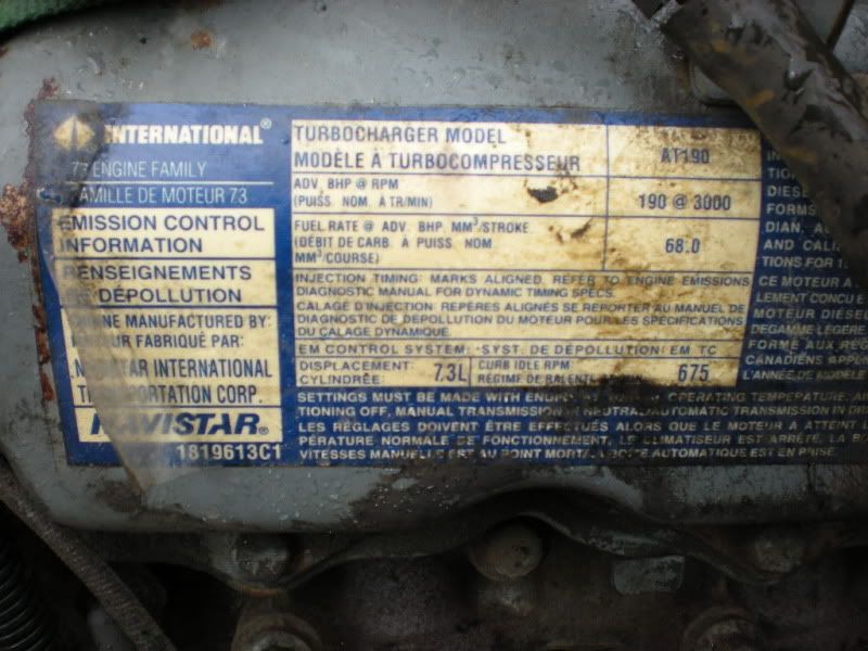

Here is some pics:
I had a lot more info, but I got signed out and lost all that I wrote... This should do for now, its late, Ill elaborate later...
