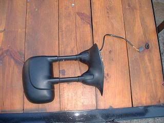

Not to be Repetative or ignorant about this question but, there are wires comming from my mirrors and I'm not sure what they are for? I know they are not turn siganals and lights, but I don't know if they are to move the mirror electrically, or heated? I'm hoping they're heated and if so how to I put the heat to them with a rocker switch?
Here are some pics of the mirror and wiring, any info is appreciated!

Adjustments. Up, down, right, left. On a '99 you have to run an additional wire from ign. switch for heat.
· Registered
577 Posts
ditto they're just for the electronic controls. if it was heated youd have two additional wires... a black (ground) and a black/white stripe.

Just run a key on power wire and a ground, you can run the power wire through a switch mounted on your dash.
· Registered
577 Posts
yea but if the mirror doesnt have it installed, you need more than just a wire.. thats the problem he just has mechanical mirror controls in the mirror itself no heat or lights. so if you replaced the mirrors with mirrors that have the heat function then yes its simply run a wire.

Ok that's what I thought, I was getting a little confused for a second. I know I need new mirrors with heat in them to get that now! Thanks:swordfight:
