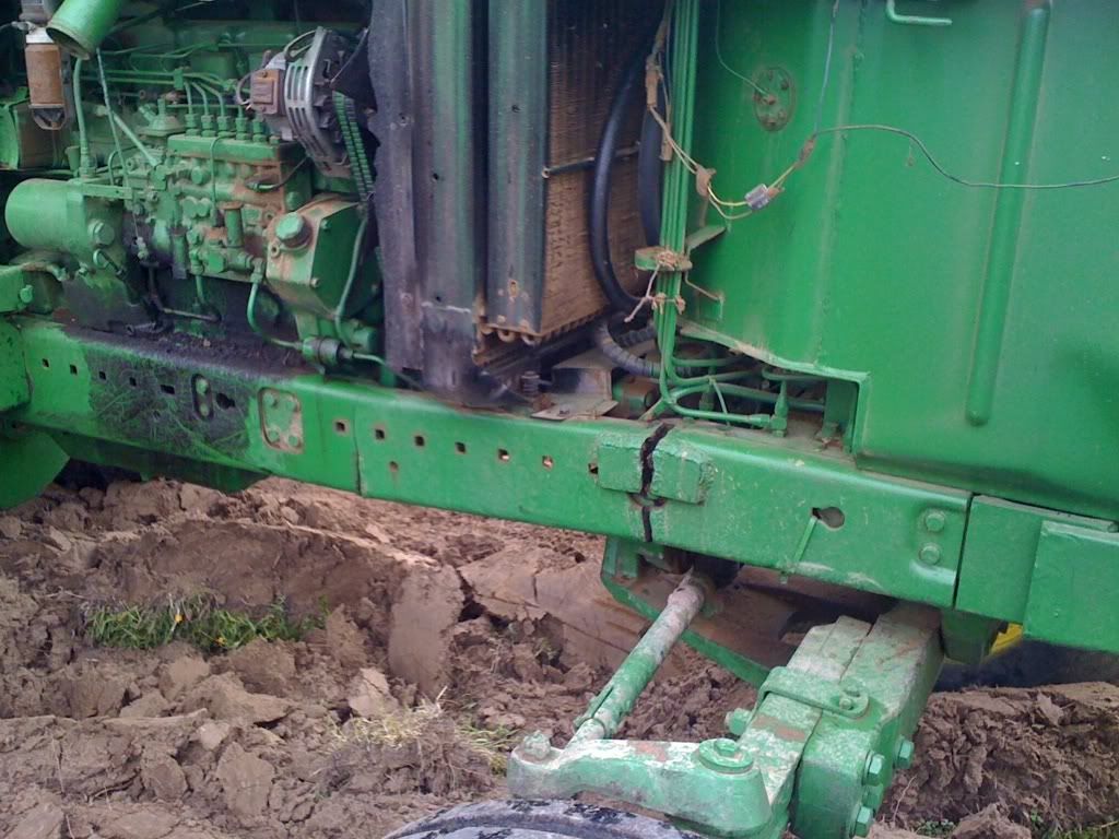

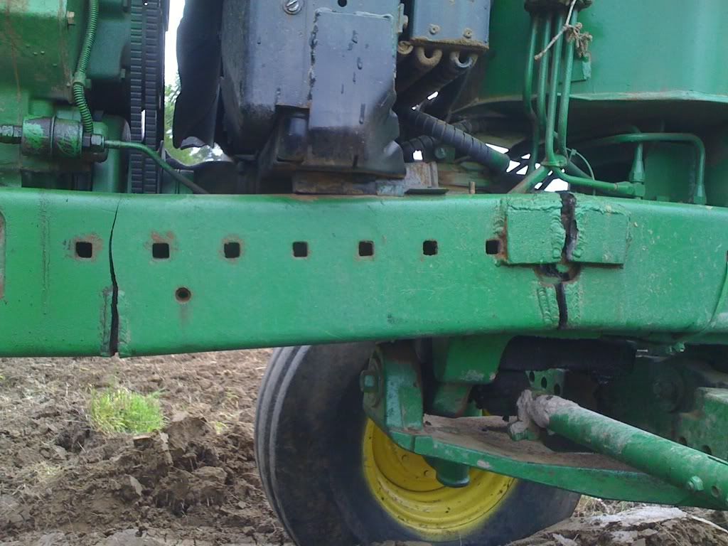

ok guys so currently blowinsmoke7.3 is setting on a tractor, but he sent me a few photos earlier that he wanted me to post up for you guys to laugh at, so please feel free to post up carnage pics you have from you broken machinery or feel free to tell a funny story about it
i beleive he said the tractor was pulling a mulboard plow
by the way myles, it looks like its also about time to give it a good wash job, u got n oil leak man, possibly from the side of the injection pump

That's a John Deere for ya.:evil But what caused the spliting??
Haters Gonna Hate
5,868 Posts
its a typical breaking spot on that series of tractor, it probably had a loader on it at some point that stressed the frame and it finally gave way, looks like maybe it has done this b4 in the exact same spots, and with the rough terrain its covering isn't helping the matters any

Thanks for posting Dillon. Yeah it needs a good wash job and some maietence but she's miles away from the shop. After looking at the tractor it looks like it already had a hairline crack in the frame and someone tried welding it back hence the block in the picture.
I guess the strain of a 6 bottom plow was too much for the ole 4850 lol

not a problem at all man, u can pick them frame rails up at the dealer for a pretty decent price, a good machine shop could build a BA set of rails though

Dang, was there an oversized loader on it before?
1,434 Posts
I'm not sure? We bought the tractor used. No mention of a loader on it from previous owner
there was another pic I sent him that shows the whole side of the tractor if he would post it up y'all could see that it would take one HELL of a big loader for it to be oversized
361 Posts
That is not a hard fix, it does get fun when all the bolts break off...and are rusted in with bovine loctite.

no there in the field still runnin while ur workin on you yahn dear, lol yes i work at john deere but thats only cuz this sh*t is always broke, i bleed red sorry :pointlaugh: the frame rail replacement is a peice of cake with an overhead hoist or a frame, do one rail at a time and make sure everything is secured b4 u take the rail off
