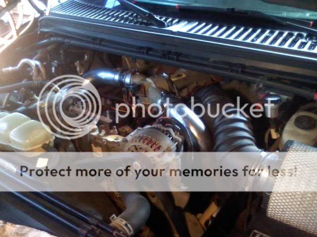

Im my boredom i decided to take things apart and clean. i steam cleaned the engine bay and decided to do the foil delete and the ccv mod. looks a little better under the hood and it was very easy to do..besides getting the insulation off the intercooler pipe!

How did you clean up your intercooler pipes so good?

Looks great man. I need to go the Foil Delete myself. Can you actually notice the turbo any more than before?

did you run the CCV out the back by the trans somewhere or did you just run it down by the motor??

I used a mixture of brake cleaner and paint thinner and a lot of elbow grease! I used a wire wheel to get all the adhesive off the foil pipe and then some aluminum cleaner/polish. they arent bad but they could be better with more time.
I ran the ccv down the frame and left it right around the fuel tank area....it was pretty easy the only thing i made sure of was the hose was well away from the up pipes!
and thanks for all the compliments! its amazing what a little steam and polish will do!
