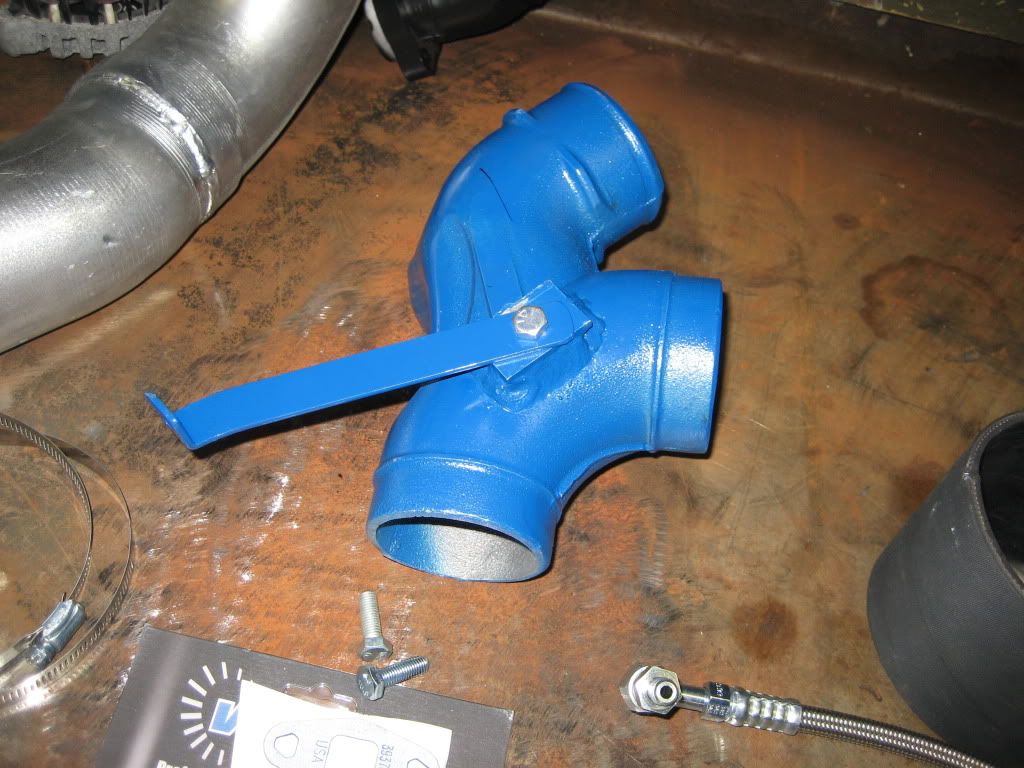

I finally got the WOP GQSSB and Carson Stauffer's ceramic coated T4i kit installed. All I can say is wow. Finished up the install last night and everything fit perfect. Now since I am still running stock injectors I expected turbo lag. The lag isn't really a issue, it also helps that I have a 6 speed but a auto I wouldn't think would have a problem either . Driving 65mph in my hot tune I get about 1-2 psi with the EGT's about 575*.
I got on it a little bit last night and let me tell you it was a blast. The turbo lights about 8 psi and when it does you better hold on.
I got the tires to spin in 2nd and 3rd gear. When the turbo lights very quick. I need a new boost gauge that goes past 30 psi. EGT's are not a issue either. I think I was at 1050* @ 30psi. I will get some videos tonight.

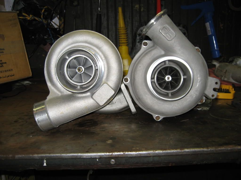

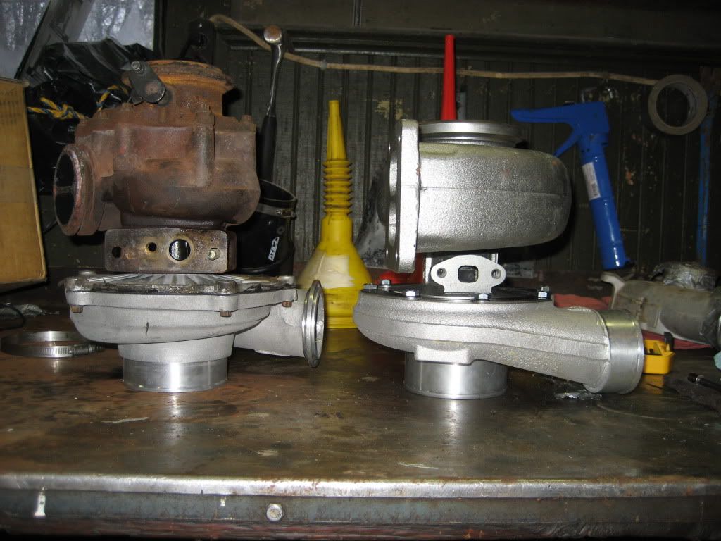

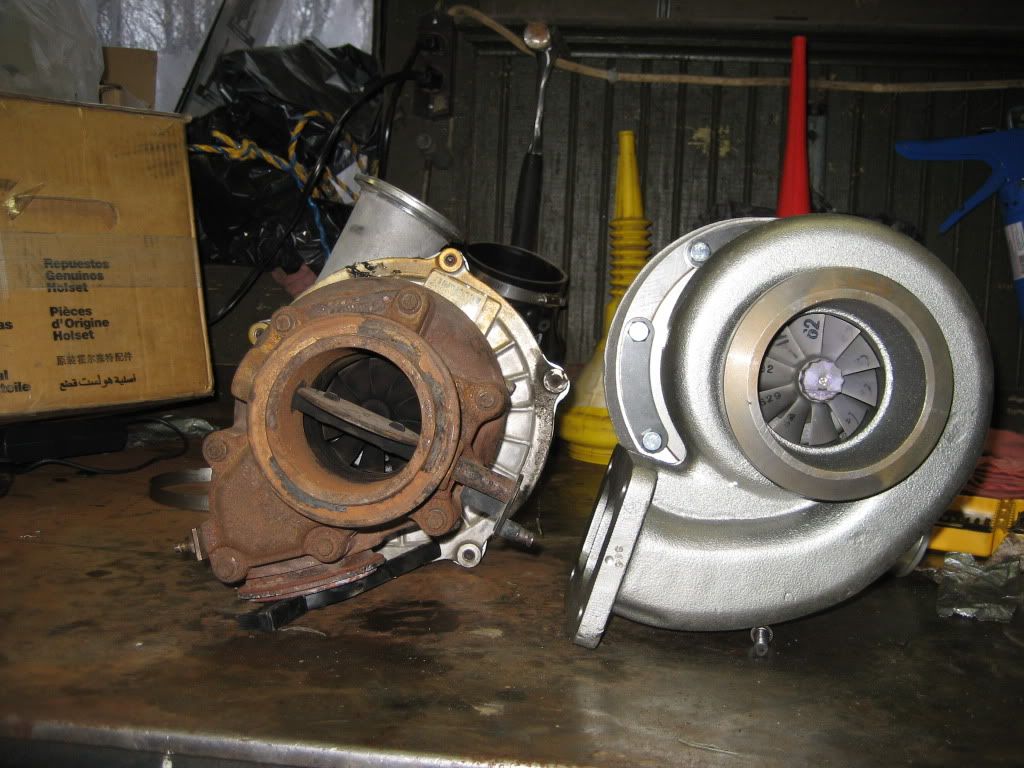

Here's a couple pictures next to a stock SD turbo with ATS housing
GQSSB and Carson's T4i Kit

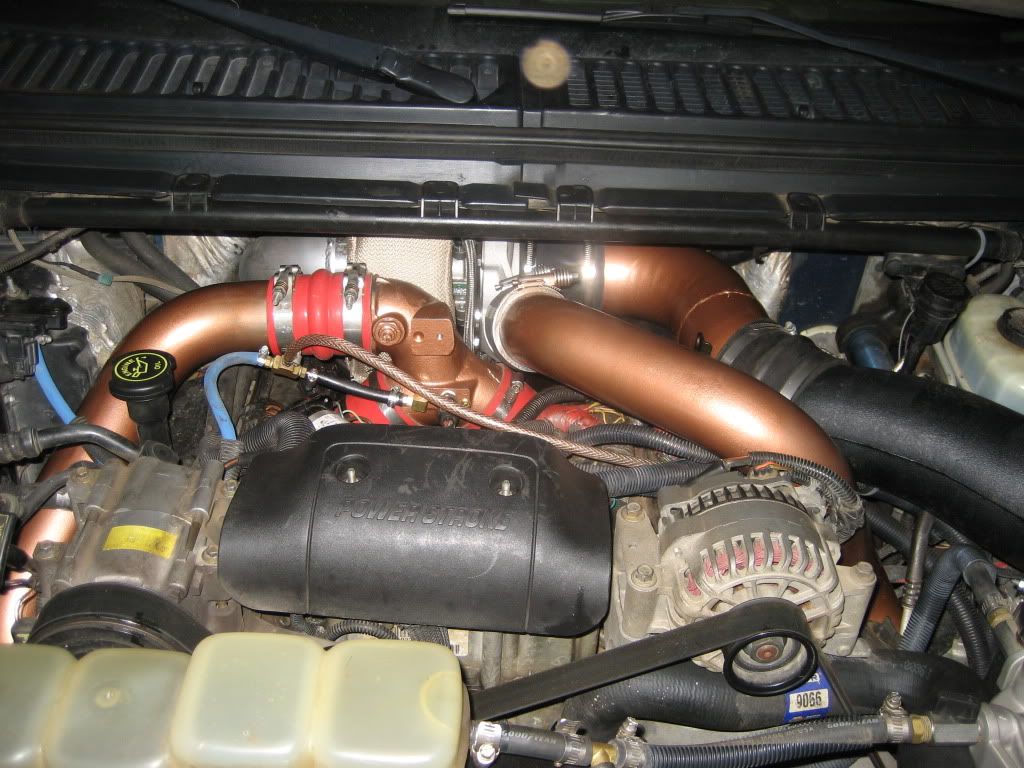

New parts make my engine bay look like chit!:doh:

What is the color of you intercooler pipes???? Copper??? I like the color..
Looks like a nice kit...

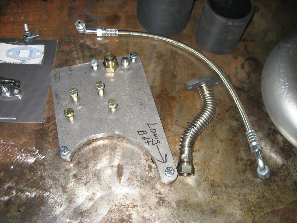

Wow that looks great. That was one of the turbos I was looking at. Still trying to decide between another. Everything in the pics is what was in the kit? Do you mind me asking what the turbo and kit cost? PM me with that.
Yea its copper. I didn't think I would like it but it looks good in the truck. Kindda hard to pic colors that go with the color of my truck, "island blue."
Jacob @ WOP and Carson @ Carson Stauffer's diesel have outstanding customer service. The quality of the products from both places is unreal.
Heres a link to Wide Open Performance WOP GQSSB Turbo
Heres a link to Carson Stauffer Diesel

that is one sweet color... were did you find the paint??? is it heat rated???

Are Carsons one of the few that makes those kits or are they the only one that make them? That seems to be a clean looking kit. I haven't seen any other so I cant compare.

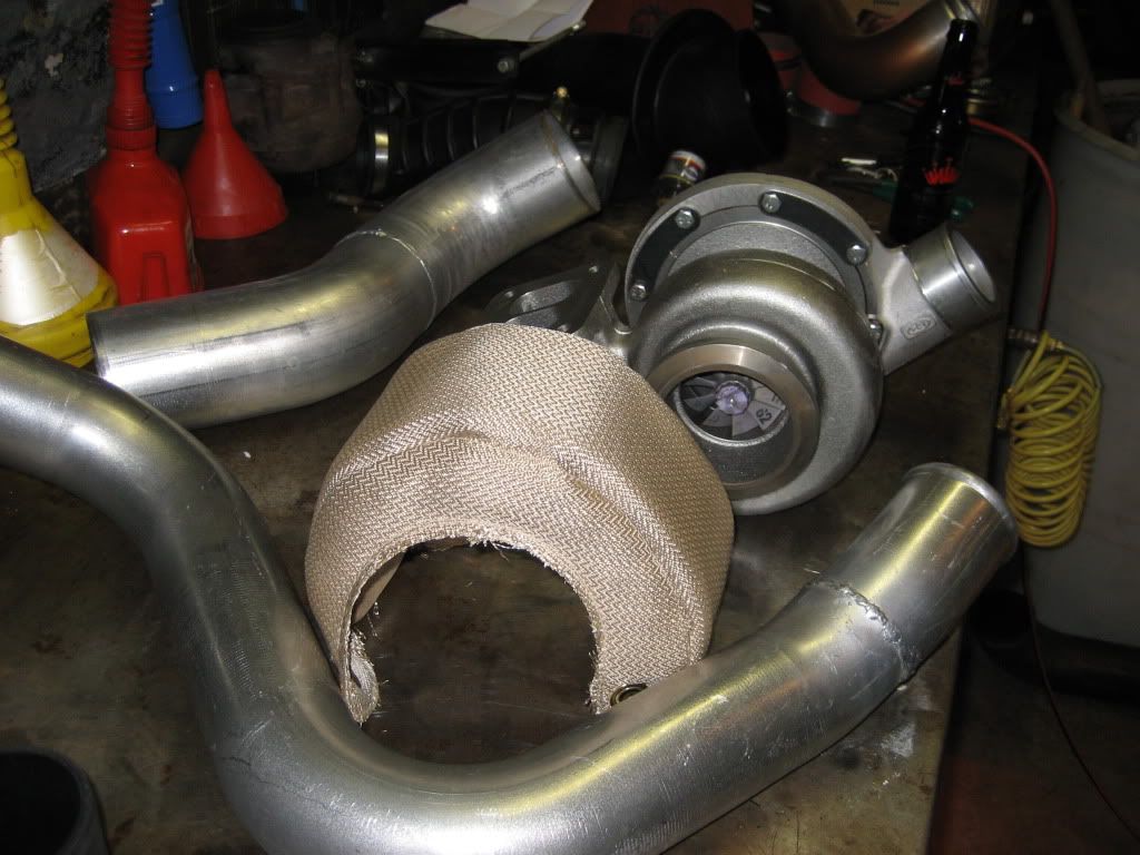

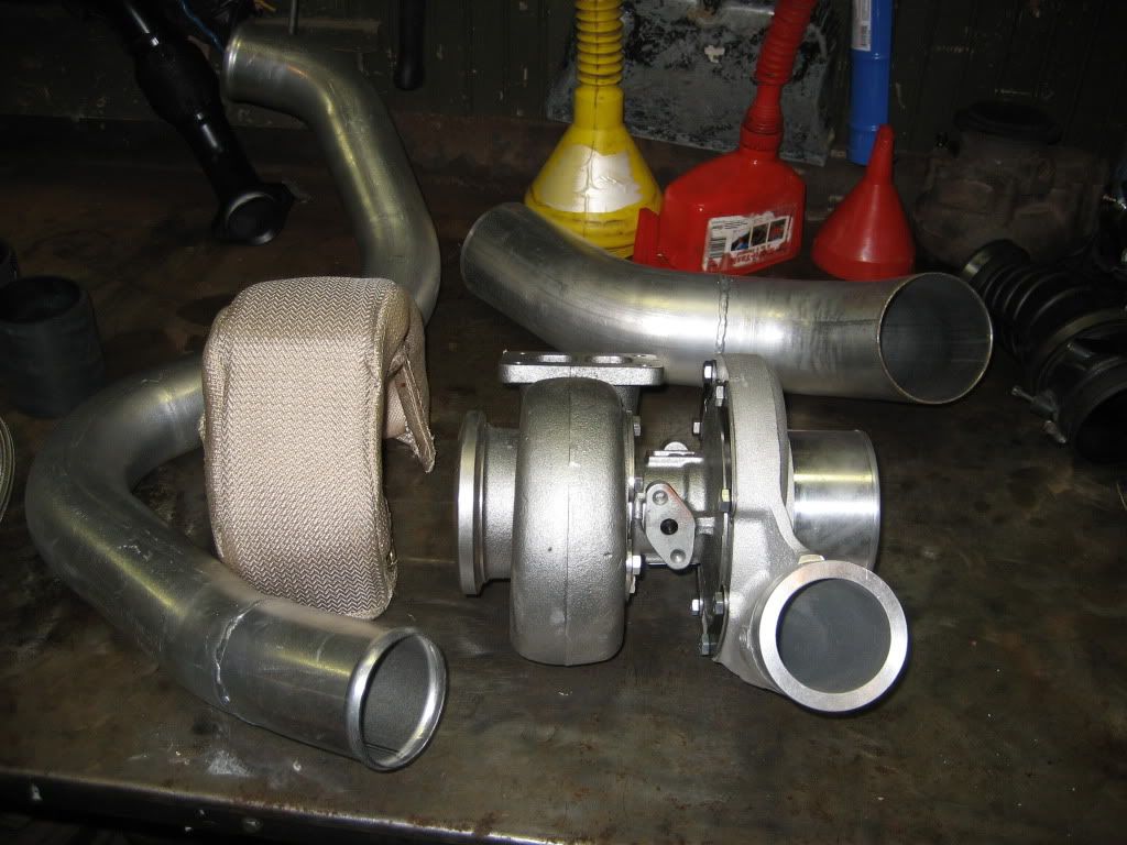

Where did you get the turbine housing heat wrap?
I've seen them advertised for a T4 turbo but always wondered how they would fit on the tall scroll of a T4i housing.
Did you have any other turbo mods to the stock turbo except for the ATS housing?
What is the spoolup like when slowly rolling into the throttle (not jumping on it) at about 1500 RPM to get up to highway speeds as compared to the stocker?
