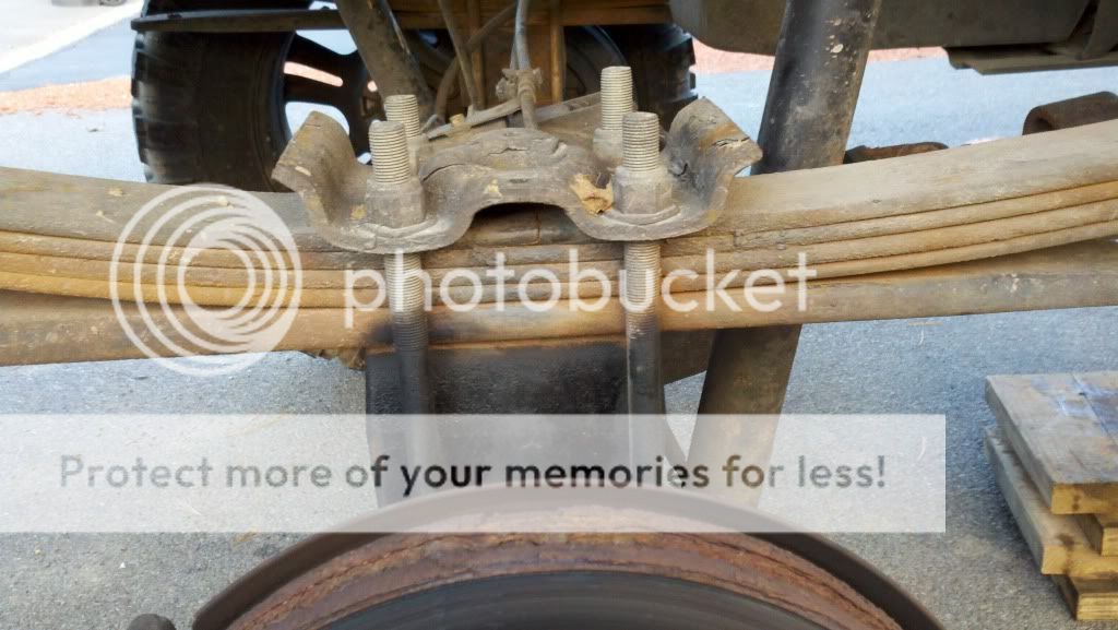

And to top it off Just look

You could have a small hole in your rad. Try running some barnsleak through it.

Leaf springs do break btw, just take it out and take it to a spring shop and have them put a new one in. Id recommend both sides just so they sit and wear evenly.

In the picture with the axle seal ,is it the drivers side? If so I would change it when you get a chance. Mine and a friend's late 99 were bad and both of our inner axle seals were bad. The driver's side short tube seems to allow water and dirt in easier and eats the inner seal. The inner seal isn't too bad to replace, but if you catch it early, it is one less thing to do. We made a tool out of all thread rod and some steel plate to install the inner seal.That really helped to make it easier. I'm no expert just going by prior experience. I would replace both sides of the springs also ,if one is broke the other is weak and will also break sooner then later. Found that out from experience also.

And the springs yes i am still working with the manufacturer. I will bring up the idea about replacing both due to the eneven ride hight or sagging/aging of the springs at different times. They have a lifetime warranty on defects so i hope to get this replaced.

I'll make comment on the rear leafs. Replace the entire pack with either Deaver or Icons. It is going to cost some money to pull the packs out, replace the broken leaf and the corresponding one on the other side, and still have the risk of another or more in the pack failing. Get some 5" lift springs and add a small block if needed to get the desired stance.

Springs - There is a lifetime warranty so i hope to get a new set from the Manufacturer and hopefully in the 8" version and not 6". Well then i will just have to lift the front then huh :)
