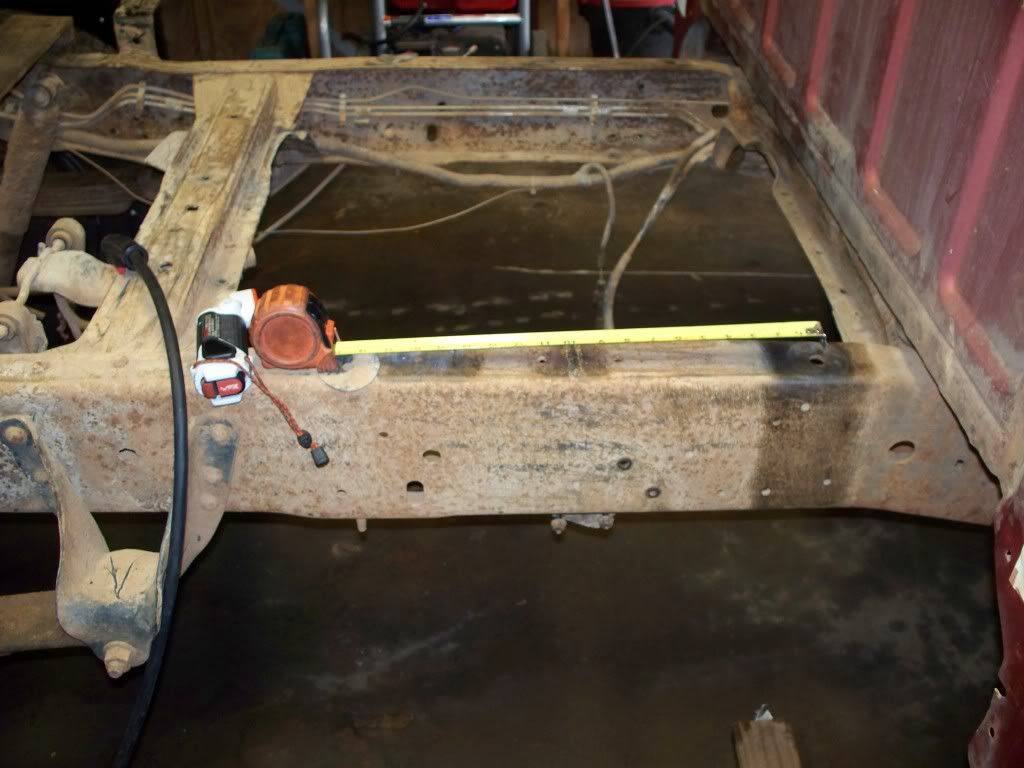

Next was the shortbed conversion, I measured and found that 16 inches would have to be removed from the center of the trucks frame
for the new bed to fit correctly. So I began by removing the driveshaft, front fuel tank, and muffler. Since I will also be doing efuel I just cut the 2 remaining fuel lines. The brake line was easy, since there was a fitting right beside the transfercase on the frame that connected the long pieces of brake line together. I just unbolted the rear side of the line, removed the correct amount of line and reflared the end. When the frame is shortened I will just hook the line back together using the existing fitting. The electrical lines running to the rear were also easy, just cut and splice.
After checking my measurments a hundred times, I made some marks and started cutting. After trying several cutting tools I ended up using a sawzall which worked great. Not having access to a lift meant alot of cussin trying to get the frame back to the right position for spotwelding. But here it is along with the section of frame I removed.

I would of Z cut that frame and fish plated it too. I cracked mine because I didn't have a large enough fish plate on mine. I took 30" out though.

not z-cutting it isn't too big of a deal, whats done is done.
but you DEFINITELY need to fishplate it, and box it.

Is it just two butt welds holding that frame together? Please, for safety sake go back and make some sandwich plates to go over that area an add some additional strength.
