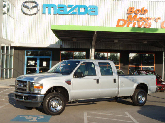

Went from this:

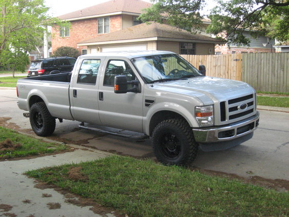

To this:
To this:
I got the towing mirrors from Dfuser and after some advice from Dzchey21 ended up deciding against the 20" wheel/tire combo I was looking at and ended up going with 18x9 V-tec wheels wrapped in 325/65/18 Hankook RT03's.
What do you think?

Looks good! I like it
521 Posts
Looks good..Maybe window tint?:confused:
3,138 Posts
Looks good. Like that painted badges. Grill is going to look good on there also.

looks good, mine will soon be down to that hieght as well, Amazing what wheels and tires do for a truck!

wheels and tires can/will make or break the looks of a truck IMO

Looks good. Did you black out your ford emblem? I did this on mine about two weeks ago, didn't have the patience to tape around the lettering, but I have an idea in mind.

it needs some tint

Yeah, I had already bought those same decals that InMotionJosh put on his rig, and I figured I'd try this out to see what it looked like. I was just bored.
The decals just showed up today too, so now I just need to decide which one I like better.
it needs some tint
Yeah, that's pretty high on the priority list too.
Thanks again for your help with the backspacing questions I had. Your estimate was almost dead on.
When I picked everything up last night, I really didn't think the tires were going to fit without rubbing a ton, but when I left pep boys today, I only heard them just barely kiss the inner fender-liner on the driver side when I was driving through the parking lot, but other than that, no rubbing on the trip home. I turned the wheels lock-to-lock and they don't seem to hit anything.
I'll get underneath the truck this weekend to double check if anything needs to be trimmed or pulled back, but I think I'm good to go.

Glad to hear it worked out for you, truck looks SOOO much better now, keep up the good work your on the right track.

Where can I get my hands on some? What colors? TIA

On a side note if anyone cares, I trimmed the fender liners on both sides to make it so the tires don't hit anywhere. I can now turn lock-to-lock like I did with the stock tires. They've got plenty of room before they hit the arms and they would only rub now if I stuffed the wheels into the fenders, which isn't likely driving on the streets.
I only had to trim a 2.5-3 inch wide by 6-8 inches in length strip out of the liners. I probably could've trimmed less, but I wanted to try and cut along lines that were already there. Kinda like opening up a wheel well.
The wheels I bought came with 5.38 inches of backspace and a +10 offset if anyone wants to try and fit wide 35's with no lift or leveling. This is just a bone stock F250.
