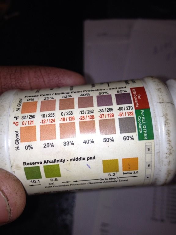

Hey guys I went to the dealer today and I asked them if they sell the test strips to check the coolant nitrate levels. They gave me a couple strips and said they don't sell them really. I took a picture of the bottle and was wondering if these are the strips everybody is using/ is this the right test strip to use ?
#2 ·
There are two seperate tests done for our orange coolant. The old style of test strips are used for checking glycol level but that is all I believe. I have the full procedure on my work computer and will post tomorrow. DO NOT USE ANY ADDITIVES IN THE ORANGE COOLANT except the right stuff. Vc 12 I think. These new orange coolant trucks are special. All other diesel truck coolant additives are wrong. No it is not the same additive for all normal trucks.
#4 ·
I bought the kit to do it myself.
328-00008 superceded by 328-R071-ELC
ANTIFREEZE COOLANT ELC CONTAMINATION KIT
Ford Rotunda Item Details page
328-00001 (3 Way HD Antifreeze Coolant Test Kit - 1 Bottle and 1 Kit)
has been superceded by 328-2050-62291
If needed VC-12 is the additive to use but can only use twice in the coolants lifespan.
It was $76 for the kit. Will last a lifetime but unfortunately has a short shelf life.

#10 ·
Caution... Use the new kit and test strips. The old style that has been used for the last twenty years or so are not the correct ones for our 2011 and up trucks...
#11 ·
Thank you Crazy Canuck for the real 'Ford Coolant Additive Instructions' PDF posted in message #3. There is so much strange and wrong commentary on this topic, and the Ford instructions make it very clear.
I found that both Acustrip (ACU-ELC4048) and Ford Rotunda (328-ACUELC4048) now sell a kit online which has two of each required tests for basically $25.
So, with two cooling systems on the 6.7L the kit provides a single use test set.
Thanks again, and I hope your post and the new part number helps someone else ...
dave
