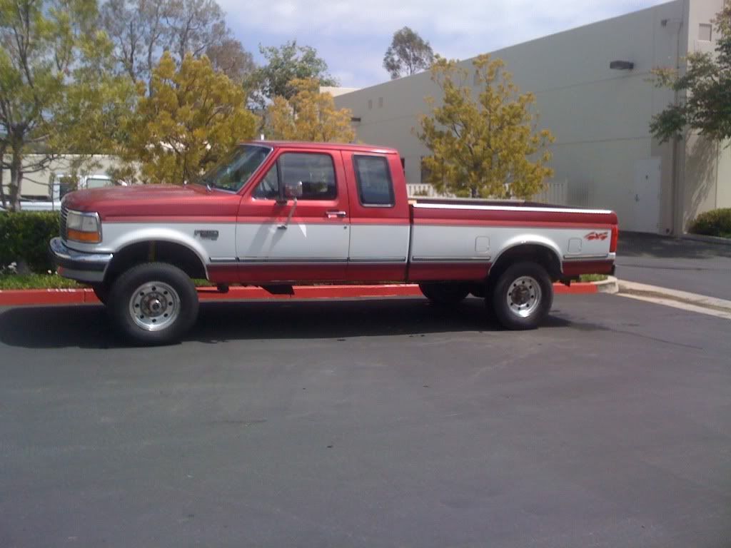

The body lines on my cab and bed seem off, well I think they are but only on the drivers side. The passanger side is fine. What would cause something like this to be happening? and whenever I hook up a trailer the bed dives more. The frame is straight and not tweaked. I bought the truck like this and thought it was the sagging cab mount bushings but after replacing them with OEM's this is still there.
In that pic I dont see anything off:confused: but it is a ford thing, the frames are designed to flex as part of the suspension.
Could it not be the cab / bed bushings? I have the same problem. I don't think my bedside was replaced because it sounds like it was bondo'd.
Holy crap:eek: Now yours is off especially for sitting on flat ground
But if you think that is bad, looky here
Yeah that's what I am worried about. I want to try to fix it before I put fiberglass on it. I can always fix it by hanging the fiberglass different to compensate, but that's a president-rig fix in my opinion.
Sadly I know all too much about these type trucks frame flex. Sometimes it eve gets stuck that way :eek:

I found some better pictures. I was talking about the bed doing this with a trailer hooked up. Some trucks do it and some don't. The frame twisting doesn't concern me but the bed sagging does. And I've been told by many going down the road with a trailer the gap between the cab and bed goes big then small then big and so on.

Now I see What you are talking about. Looks as thought the frame is bending right behind the cab, almost as if it is going to brake:eek:

So anyone know why the trucks do this?
From everything I have read over the last couple years, it's just frame flex. I can watch my bed and cab move separately over bumps driving down the road looking in the rear view mirror. As a kid in my dads 97 psd towing a bumper pull, I could watch the bed move several inches as we were going around corners and bumps.

Yea, as said these frames flex, sometimes alot. I have some pics you should see of my 94 at some pulls, and tug of wars. (stock frame, no reinforcement or bars etc) Scarry how much it flexes. Ive never seen one flex like my 94 has. IDI Low end torque I guess.:ford:

LOL. You should see my 1980 pulling truck flex(429 and the swiss cheese frame):doh:
