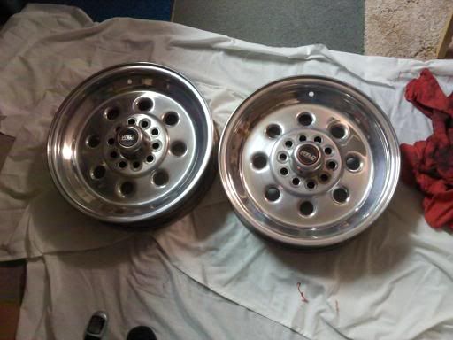

I just picked up some weld drag lites for the stang, the rears look like brand new, but the fronts need some love.
I tried cleaning up on them with what I already had at the house.
^^^the #### took all the road grime and brake dust off the front and back like it was nothing. the back side of the front wheels were solid black.
I picked up one of these at walmart hoping I could polish the fronts better then doing it by hand. It seemed to work ok, I MAY get a mothers ball as well just to see if one is better then the other.
As far as polish when I picked up the bullit I picked up some mohers.
I had some "hand Polish" I tried it also:
Everything I used made them shine, no doubt. The promlem is there still is little imperfections on the fronts of the front wheels. Im thinking I need more of a cutting compound, what go you guys suggest? What do you use?

Here are 2 more pics, they show the spots im talking about a little better:
No 6.0

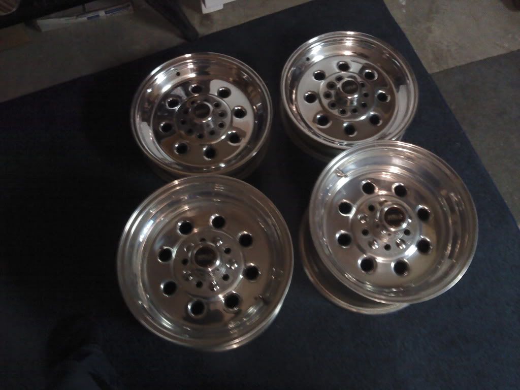

Before
After
Process was...
Wash
Claybar with Meguiar's Medium Claybar
Polish using Meguiar's NXT Metal Polish. I ran out mid way and switched to Mother's Metal Polish. I did NOT use the liquid polishes in the bottles. I had better luck with the paste polishes (come in the little tubs, I had both and tried both). I would scoop it onto the wheel with my hand and polished using a Mother's Powerball, the small one. After those pics were taken, I put a few coats of Meguiar's NXT wax on it. That was exactly a year ago, and the wheels still look great today.
