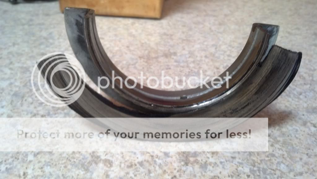

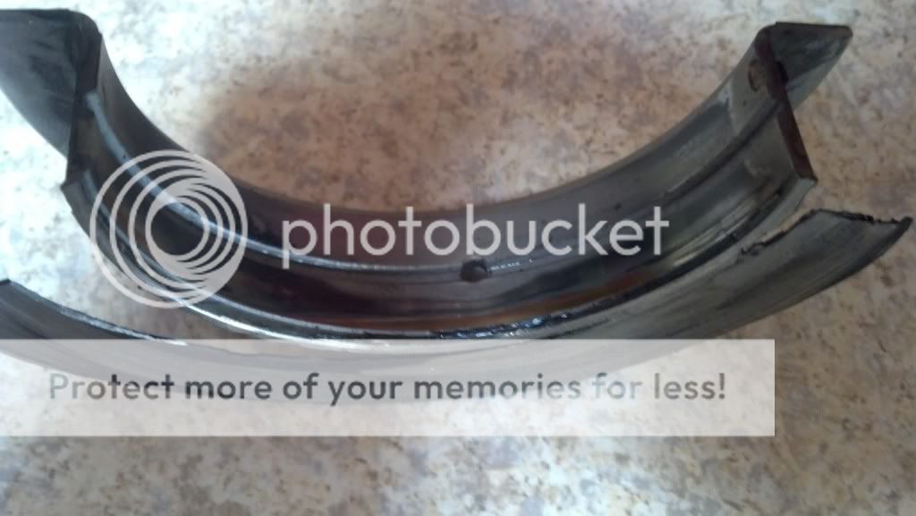

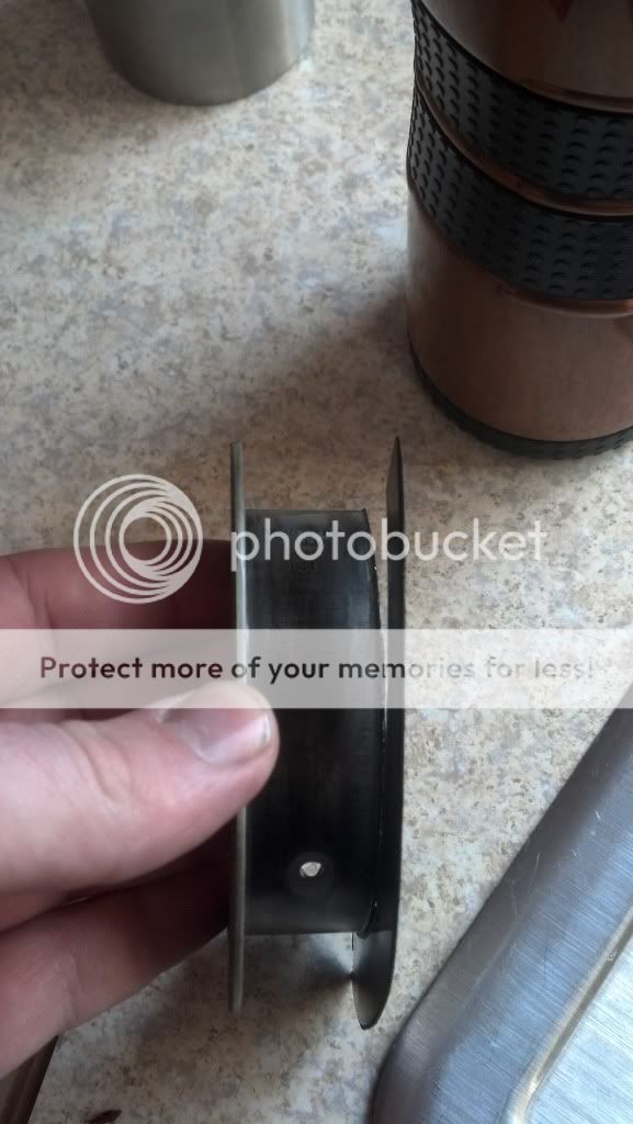

what would cause this? swollen converter transmission issue? bad bearing to start with?, I'm rebuilding the engine now the crank was shot and block was almost toast as you can see by the bearing. i want to make sure i don't overlook something going back together because i don't want to do this again the truck had 260k on the clock

the old crank is still at the machine shop, had to re use the gear and adaptor ring off it for a different used crank with low miles that i got a deal on. I'll get some pics of it up to but basically the surface of the crank that is supposed to ride against the bearing is all worn down and grooved really bad, i have been fighting this belt chirp for a really long time only chirped when it got under 50 degrees outside put a new belt on it it would go away for a while then it would always come back,earlier in the summer while i was studding and doing all the normal crap i noticed the front main seal was leaking i pulled the damper off and found the front seal pushed out about half way now at the time i didn't really think to much of it i just replaced it and moved on till this year i got my injectors and turbo and while i was doing my fuel system i was checking everything under the truck out an boom like a slap to the face front seal leaking again so off the dampener came and there it was pushed half way out again so this time i checked end play and i ain't kiddin i had 3/16 to 1/4" end play max spec is.020 so i jerked the engine right there and found the thrust bearing in this condition. the kicker is my good friend has a shop that caters to p stroke owners and he had another truck in there with over 200k on it and i went over to it with a pry bar and it had at least 1/8" play in it i looked at another used engine for sale and it was the same way so if you ask me i think this problem is more common than a guy would think because let's be honest who checks their end play if they don't have an obvious reason to both the other engines i checked had no leak from either front or rear seals, my truck had no other symptoms weird noises or anything it ran great.

yep id put money on it the thrust bearing on your uncles truck went and as a result the crank went right after, i noticed on my truck before i pulled the dampener off the inside two ribs of the belt were missin, makes perfect sense why i had the chirp and why the belt was dinked, what year was your uncles truck?
