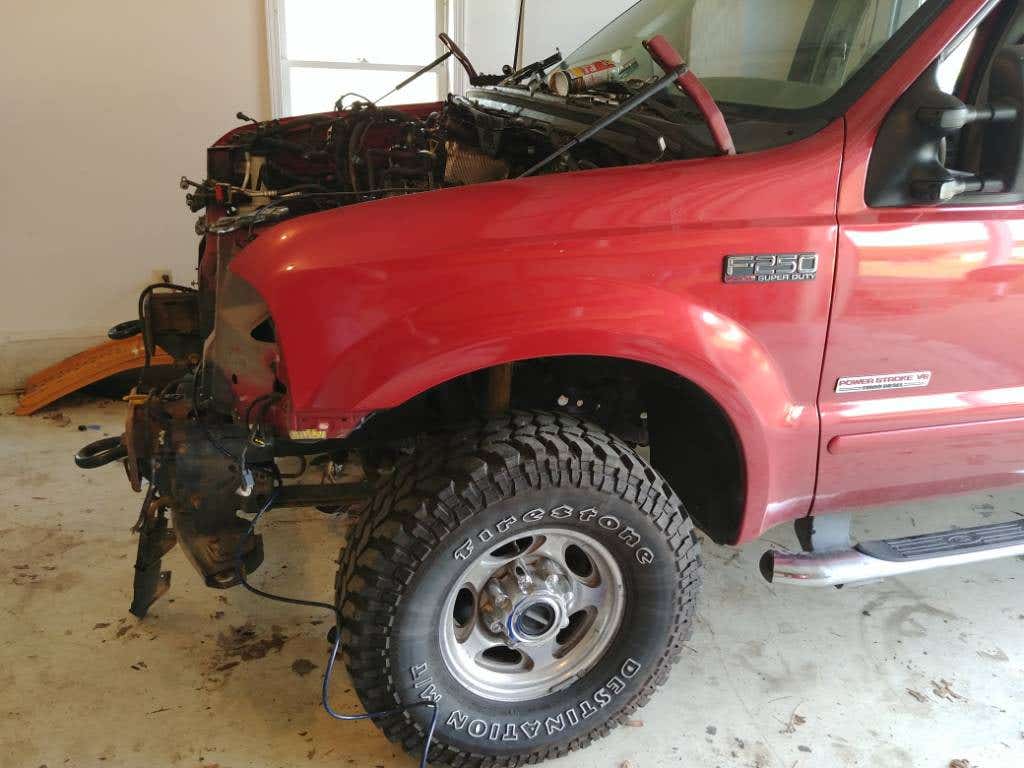

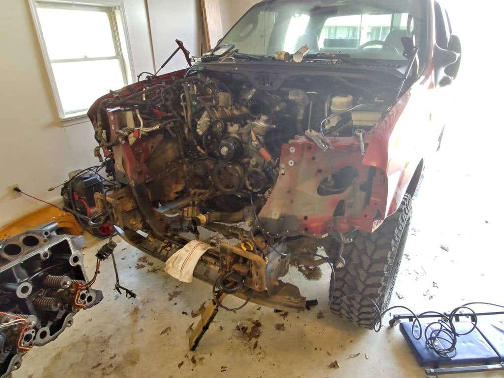

Discussion starter · #51 ·

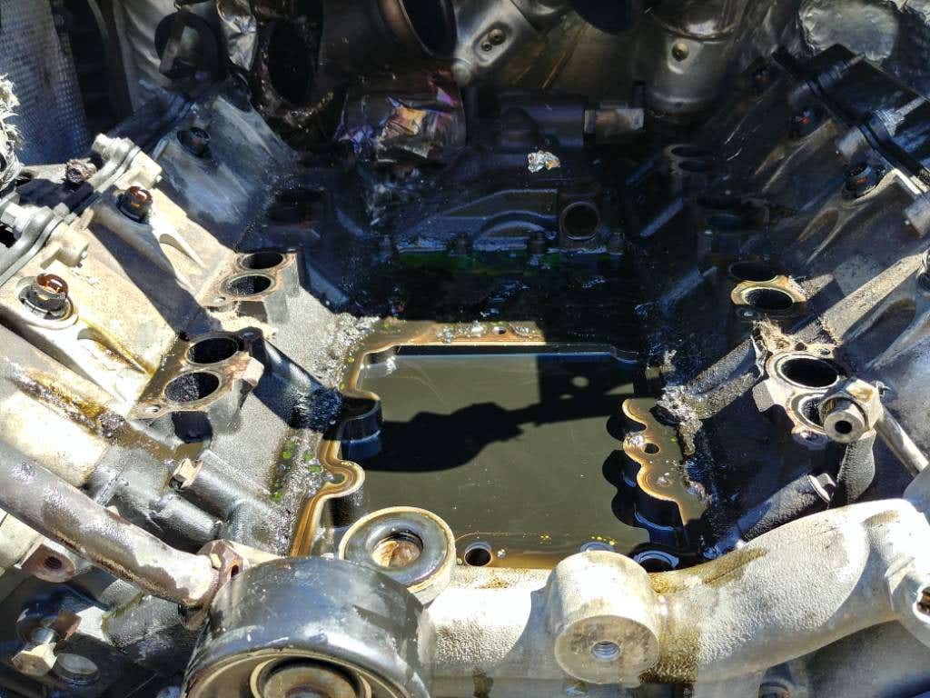

Thanks guys. I got the bolt loose from the turbo back in the spring.
I started putting the motor back together a few days ago. Ill post pictures as I go.
Right now I'm looking for a deal on a frobt bumper, upper wind deflector, and I can't for tge life of me find the part numbers for the Damn feed and return fuel lines that connect to the filter housing.
As you can see. I got really pissed at this line
Sent from my LG-H872 using Tapatalk

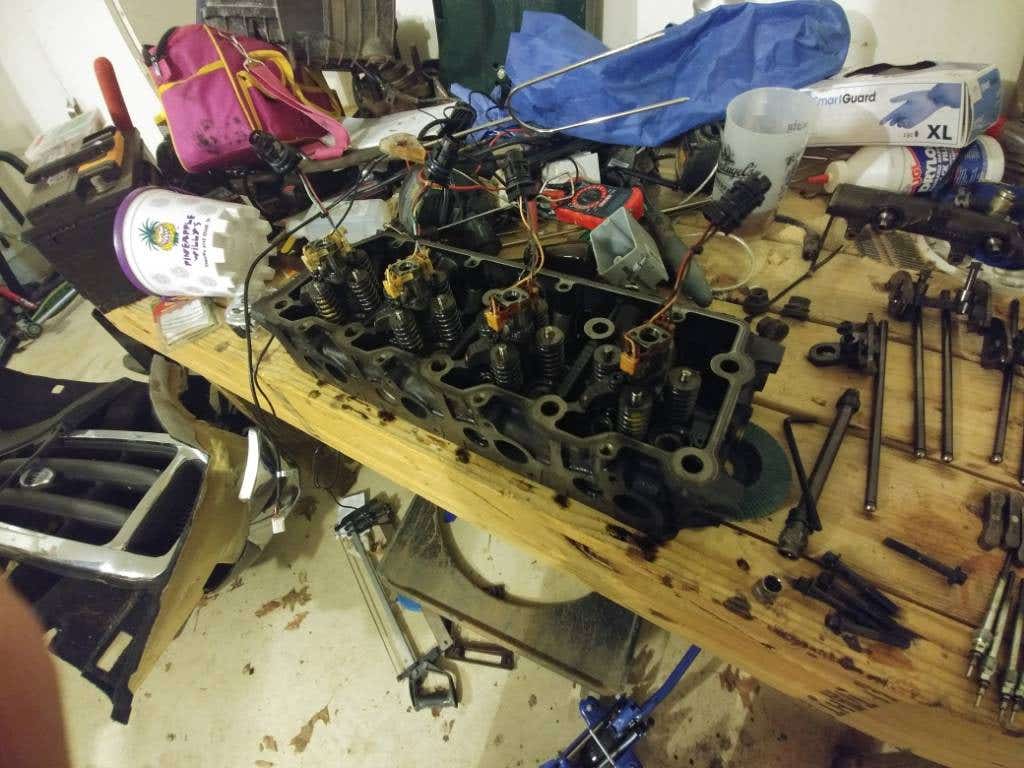

I ended up ordering a rebuild kit. Should be in tomorrow. My turbo is in good shape but what the hell I've come this far so why not.
Discussion starter · #53 ·
Obviously I tried to separate the two nuts but they are fused together. Penetrating lube wouldnt even do it .
