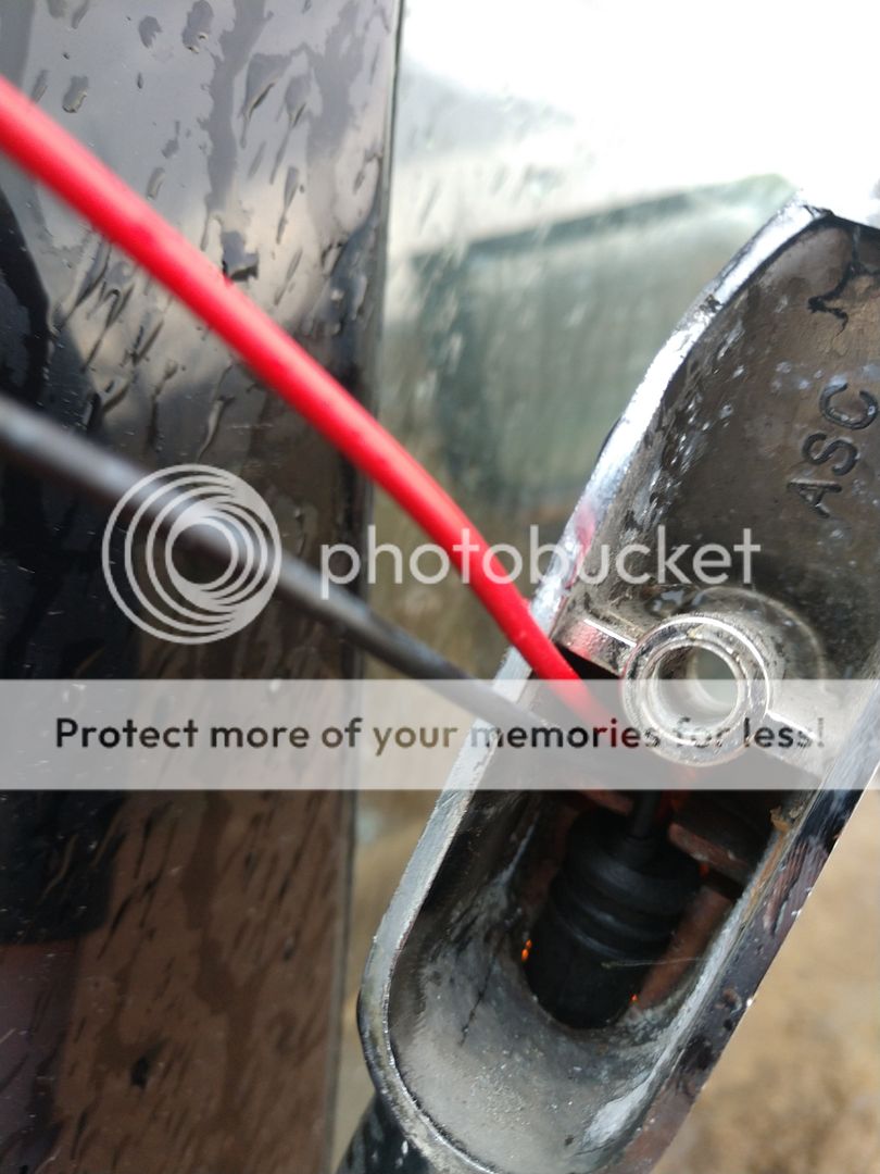

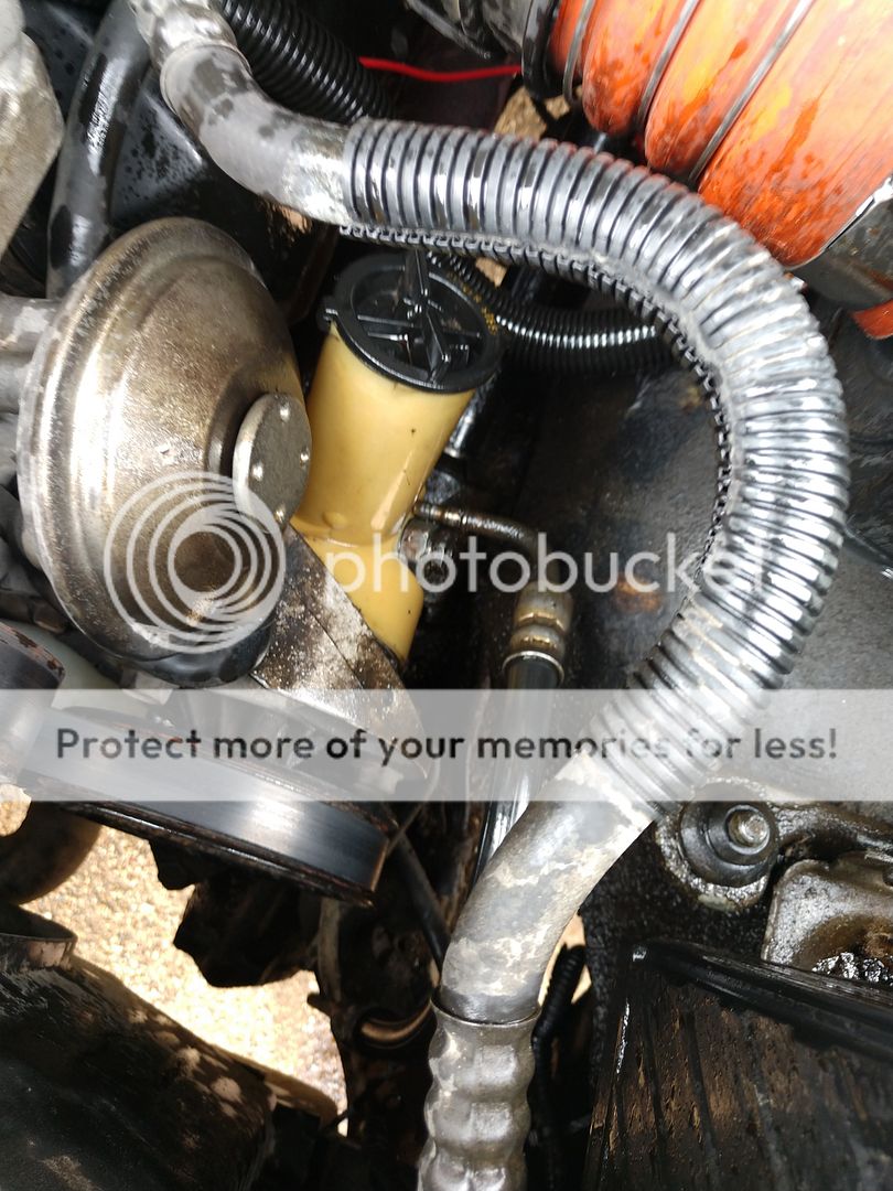

Well had a nice surprise today, turned around backed into the driveway and heard pop and the steering wheel really yanked in my hand, i figured something in the steering linkage had broke, turns out the pressure line had blown apart at the pump, never had a steering wheel jerk like that from loss of pressure. So jumped on the bike ran to the parts store picked up a line, i had looked it over decided the line would come off easier with the pump out since it had been whining and leaking anyway i figured id just replace it, ofcourse i still have my puller locked in my toolbox at work didnt want to drive over there so just bought a new pulley also get home start tearing into it whne i realize you cant even remove the pump without pulling the pulley so i just replaced the line, we'll return the rest of it and order a motorcraft pump, new line on filled with fluid she steering really nice again
after that decided i would work on the new sockets for the grab bars ofcourse i just get the first one unbolted when suddenly it starts to down pour, this was the only one left not working so i started with it, but the rest all should really have new sockets also, had em all crimped up nice with spade connectors and stuff so they could be easy to remove when find out the connectors wont fit through the hole in the cab so cut em back off and just butt connect them together, everyhting else is a really nice fit though, ordered the sockets off amazon like 5 bucks for a bag not to bad

Are the sockets for the exterior lights? I couldn't totally recognize it in the photos.

sockets are for the illuminated grab handles, i really need to get some rubber and make new gaskets for them also as they're starting to leak and get corrosion causing the bulbs not to light, i did replace the bulbs in most of them just from being burned out but they also had some pretty nasty corrosion so going to replace the sockets as well
I had an extra package of bulbs so i threw some in the door courtesy lights but i see the passenger side has melted out of its holder so probably have to replace that one, id like to find an LED replacement
