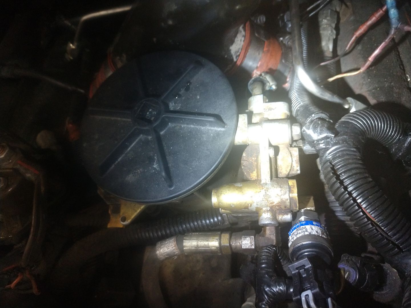

I took a couple minutes and installed the sensor in that location, im only reading about 20psi hopefully its not a good place to take a reading or i have issues, ive been prepairing an efuel setup but not quite ready yet

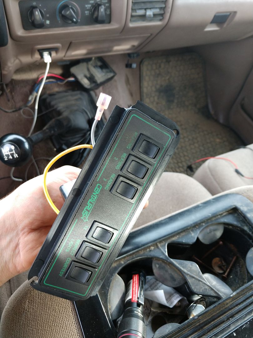

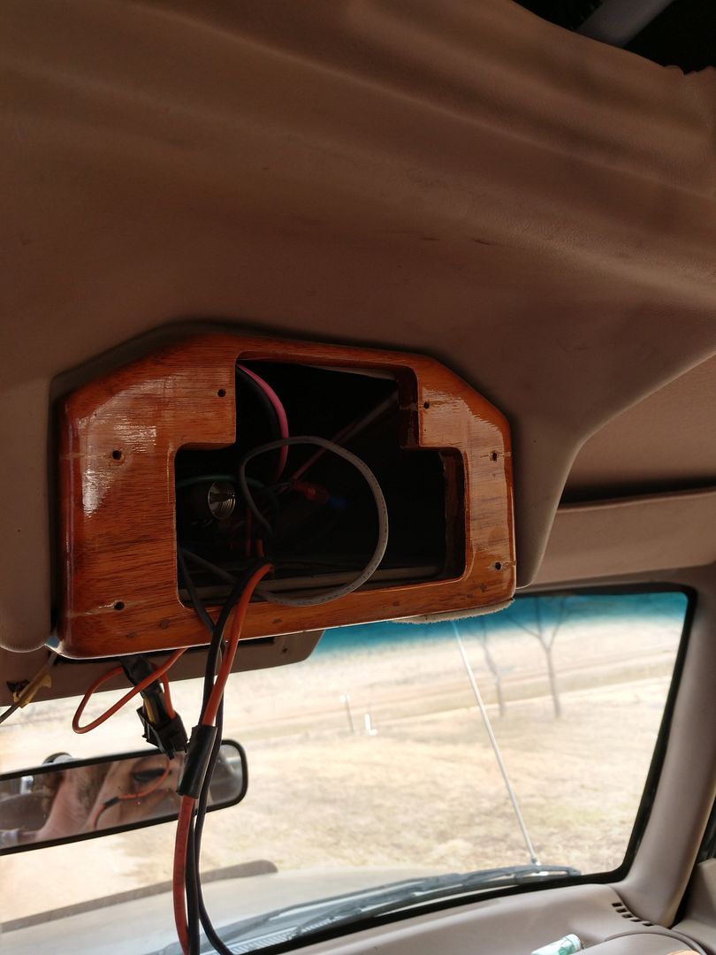

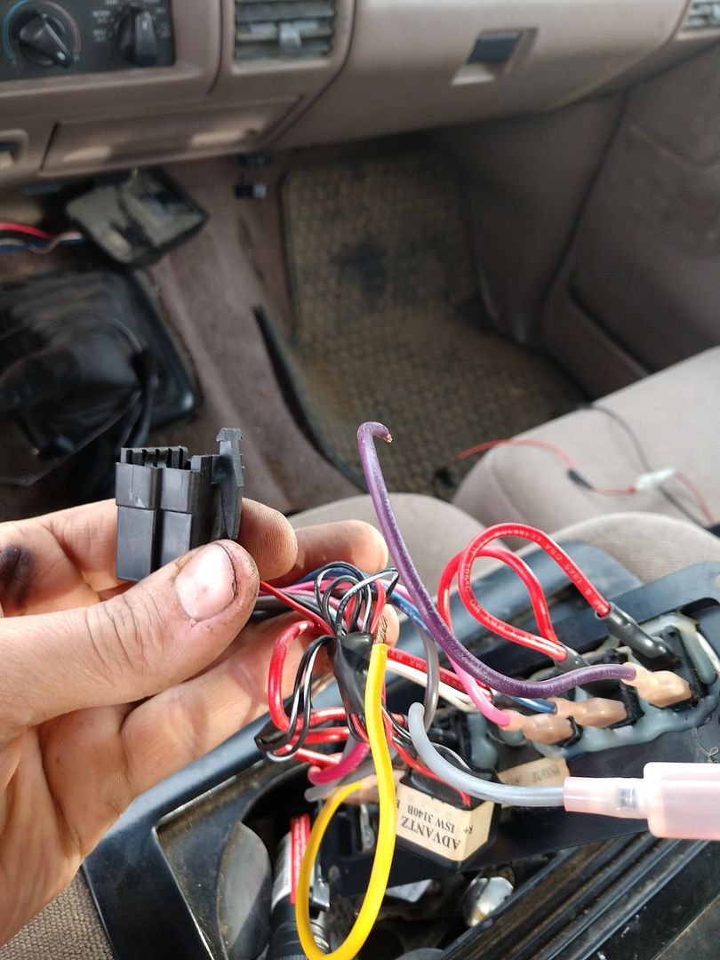

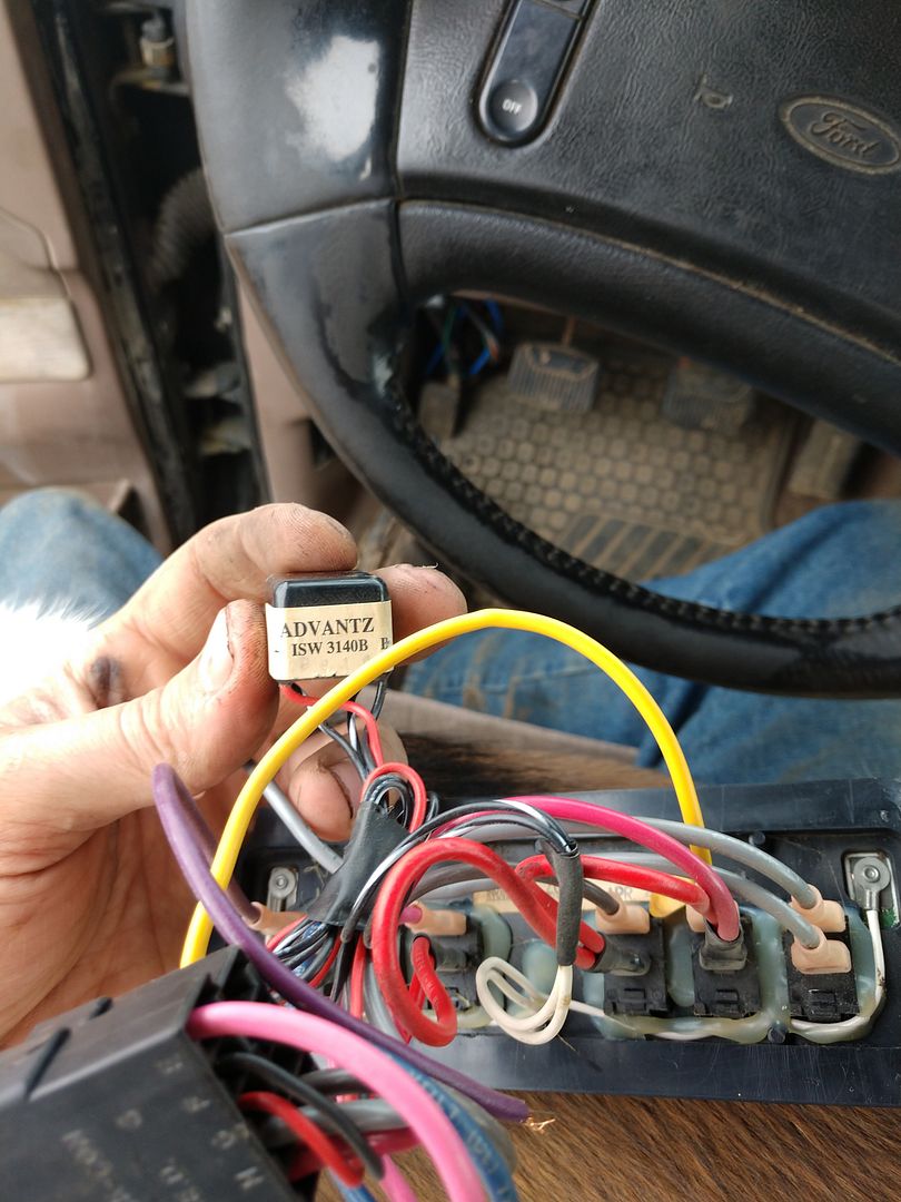

Was bored tonight with this nice evening i took upon myself to investigate the conversion parts a little bit, sadly i think the "mood light" down the middle is burned up, have to look into some led strips to replace it or something like that, when removing the control panel i found a couple crimps had come loose on the connector and iw as optimistic this would fix the issues but sadly it did not, it did fix the map lights but the mood light still do not work

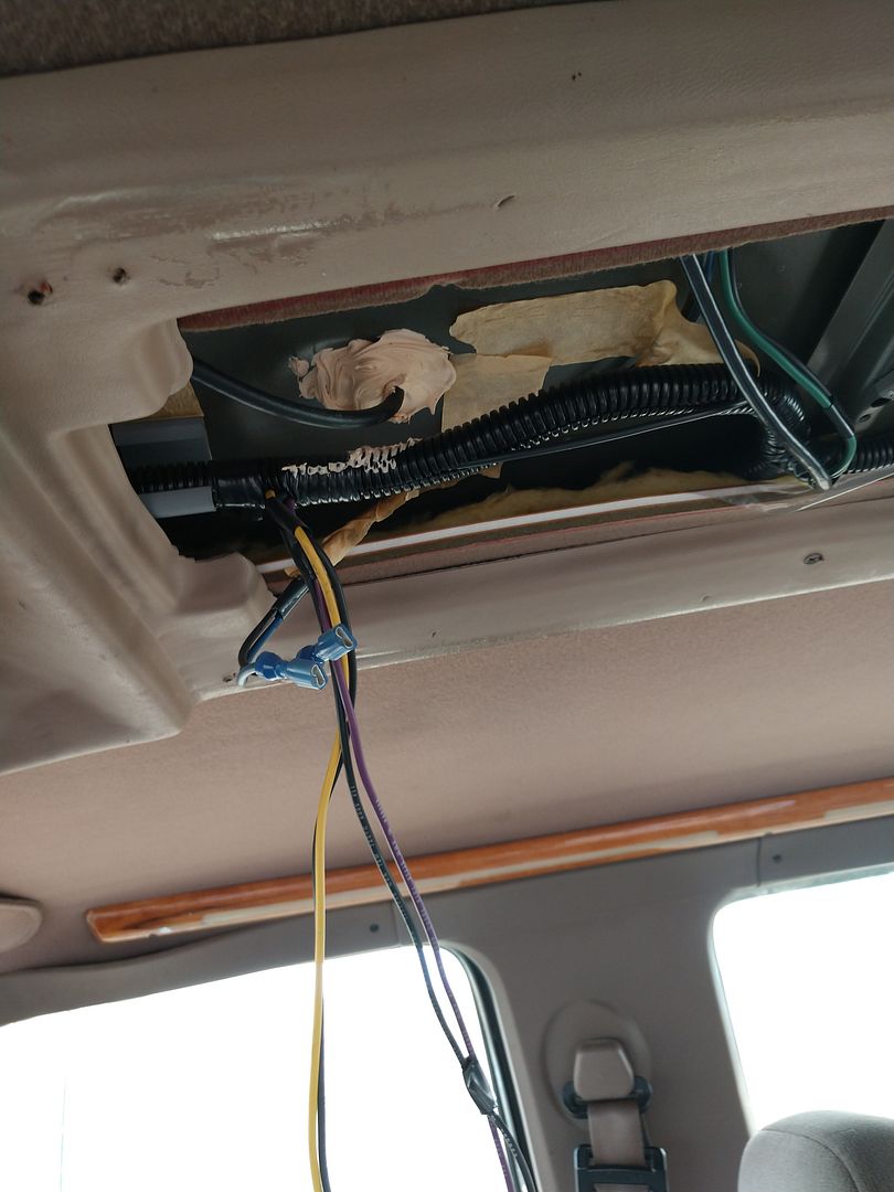

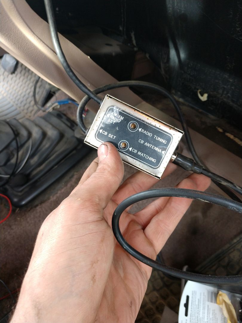

I chased the coax through the truck and found they're actually piggy backing the cb and am/fm antenna so glad i didnt hook my expensive cb up to it yet im afraid that might burn it up, always was kind of a hokey looking antenna at best, found the connection behind the glove box so i can tie back in there and hook the am/fm back the way it should be, though it hasnt been working to bad, probably try and see if i can get the pins out and re crimp them and dab a little solder on em so they don't come apart again, going to have to cut the opening bigger to to fit my big radio in there, also trying to figure out this little box on the control panel near as i can tell its suppose to control the back lighting for the panel, not sur eif its a resistor or what exactly

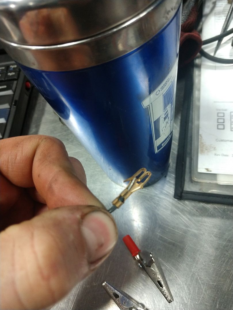

had a couple extra minutes at work this morning so i tackled the panel repair quick was super easy, paper clip could release the pins pulled em out opened up the crimp and recrimped the wire, dabbed some solder on for good measure and stuck the pins back in, might double check the crimps on the rest of em just to be safe, probably wont solder though as they seem like poor quality pins they didn't take the heat as well as i wouldve liked but they did lock back into place so should be good to go

also finished up with my control panel it appears it is supposed to be backlit and my best guess is the little box is some sort of voltage knock down for what appears to be a circuit board doing the back lighting, i get 450k ohms going into it from the panel side and the panel has 75ohms not sure a good reading for these so who knows where the issue might be thought i struck cold on the back side though the power wires coming from the plug to the black box had high resistance so i popped them apart and measure individually, found the black wire was the cause of high resistance, pulled the pin on the connector to check for a bad crimp found whoever crimped it crimped the insulation not the wire....... i fiddle with it some to pull it apart and decided it wasn't worth damaging the pin if its crimped that good just melted some solder in there and solved the high resistance but sadly after plugging it into the truck still no back light so the chase continues, i have not verified voltage on the chassis side either so could be an issue there yet

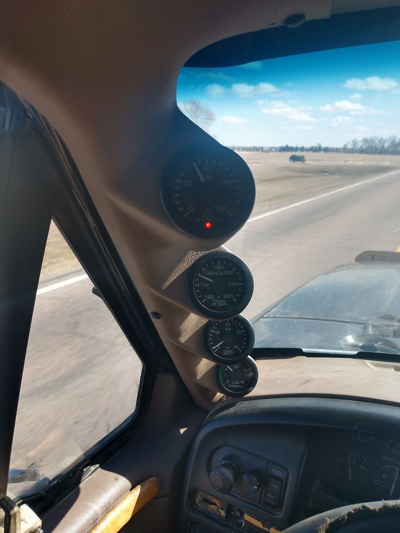

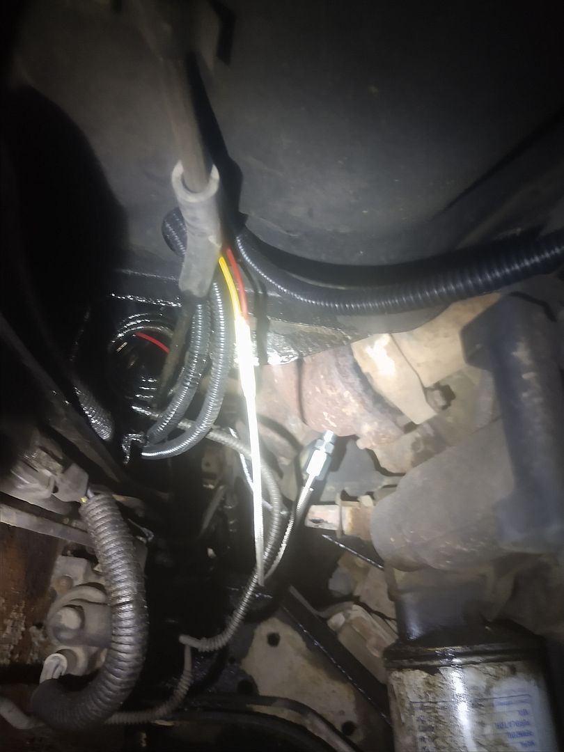

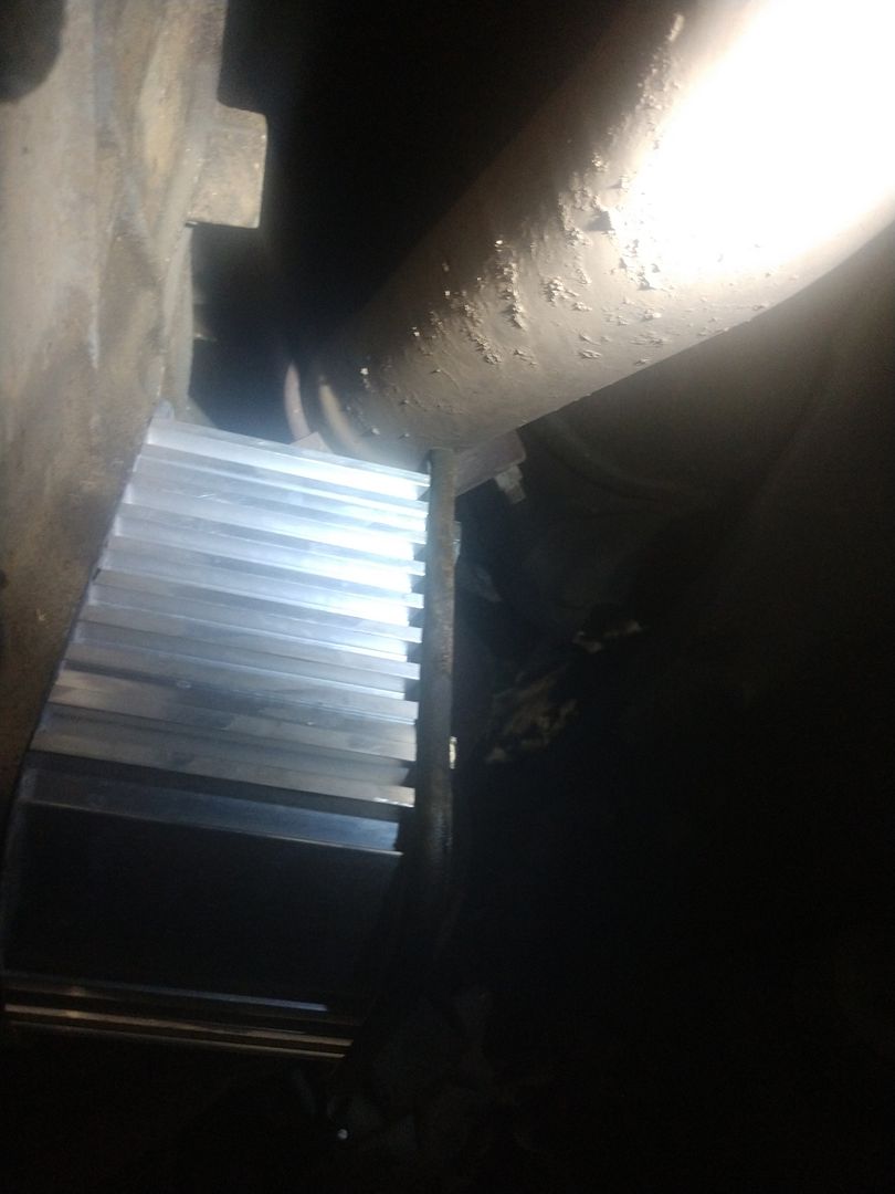

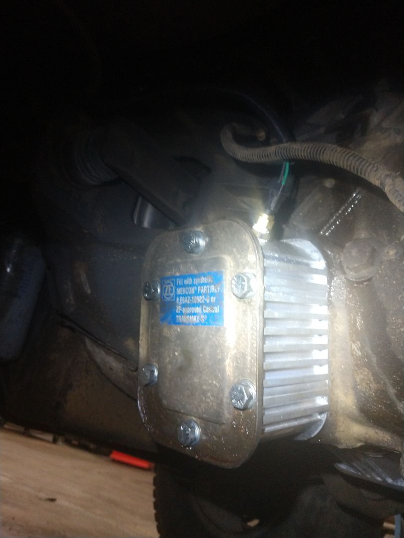

Dove into finishing my gauges this afternoon decided to go ahead and do the trans coolers probably wasn't a bad idea either, fluid didn't look the most amazing ever, pretty decent clearance around everything, im not sure the proper fluid level for these things I thought i read 4qts? sure doesnt seem like much, the coolers add about 1qt each so i started with six and i could seen anything through the top so i added 3 more then i could see the fluid level creeping up the gears, filled everything through the top, also while doing this i discovered my reverse light switch was unplugged connector all corroded so looks like ill probably order a new pig tail and switch
drilled and tapped the intake y for boost and drivers side manifold for EGT pretty simple jobs, yes I know the engine bay still needs cleaned up waiting till i get everything done so i dont have to do it twice
and i switched the fuel pressure sender over to the test port location, now im reading 45psi at idle and 35 running at 65, so looks like i need a fuel pump or maybe a regulator
was suprised trans temp go to 180*F just driving home 15-20miles and its only 35*F outside today
also had to throw my driver mudflap on again yards been kinda soft with the thaw backed up in a rut and ripped it off

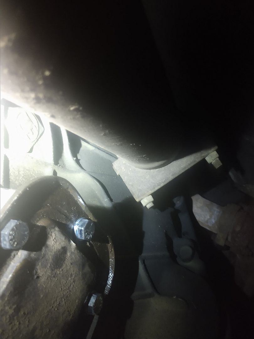

Also while rolling around i discovered my water pump is dripping so add that to list, its actually somewhat of a relief i've been smelling coolant but not seeing anything, and i've added about a gallon since i bought the truck, i was worried bout head gaskets or injector cups, and ofcource my marvelous power steering leak and it does appear maybe the oil cooler is added to the mix, probably get those ordered too

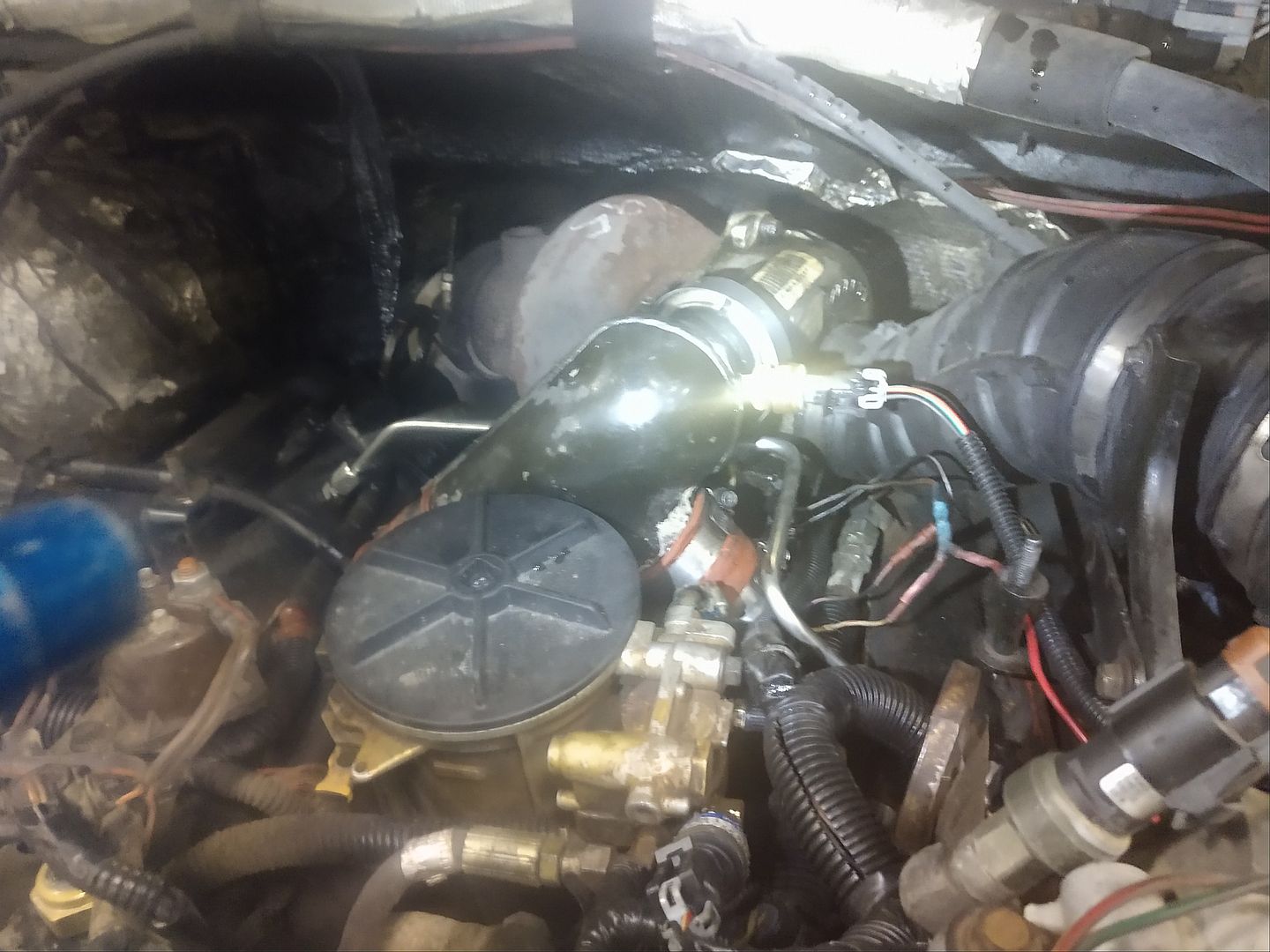

Well I played around with the regulator this morning, I was thinking it's just a spring it either needs a shim or stretched, well after getting on the interwebs I discovered this is already a thing, so I set out to do what is know the BB mod, of course now that I need them the little BB tube is no where to be found so I settled for some steel shot out of a shot gun shell, of course they're smaller so I cut the head off a screw that fit in the hole and in the spring and drop in one shot to start with, in total this gave me around an 1/8" of shim which is slightly larger then a BB but I was running down to the 35psi range I figured it needed some extra help
All back together it's now running just shy of 70psi at idle cruising 60-65, hard WOT pulls I can get it down to 50 but barely so I think we should be good to go until the efuel is ready, truck runs way better, sounds better get about 20psi out if it now

Best thing for the transmission is to try to add five quarts by adding an extra quarts through the shift tower in the floor. That's what most of us do. Or you can park it on an incline leaning away from you and put an extra quart in that way through the fill hole.
Nice work on the fuel system. Low fuel pressure is bad for the injectors,....that's why I probably sounds so much better.
