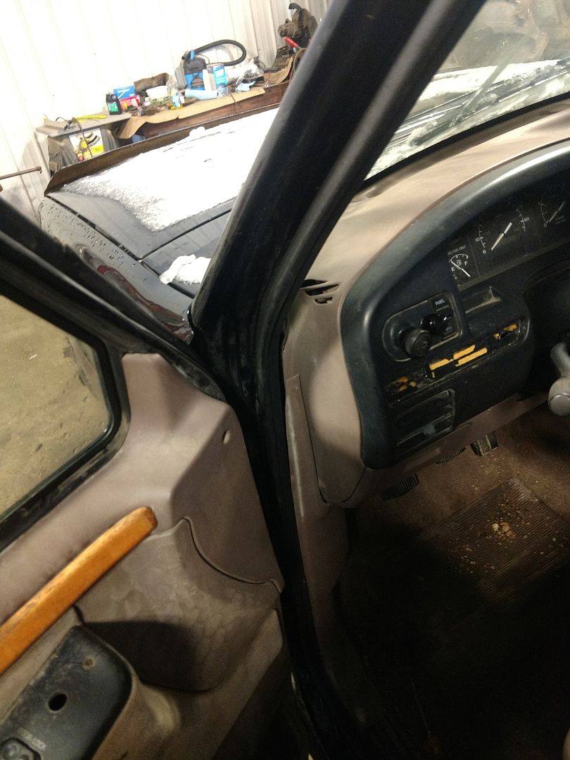

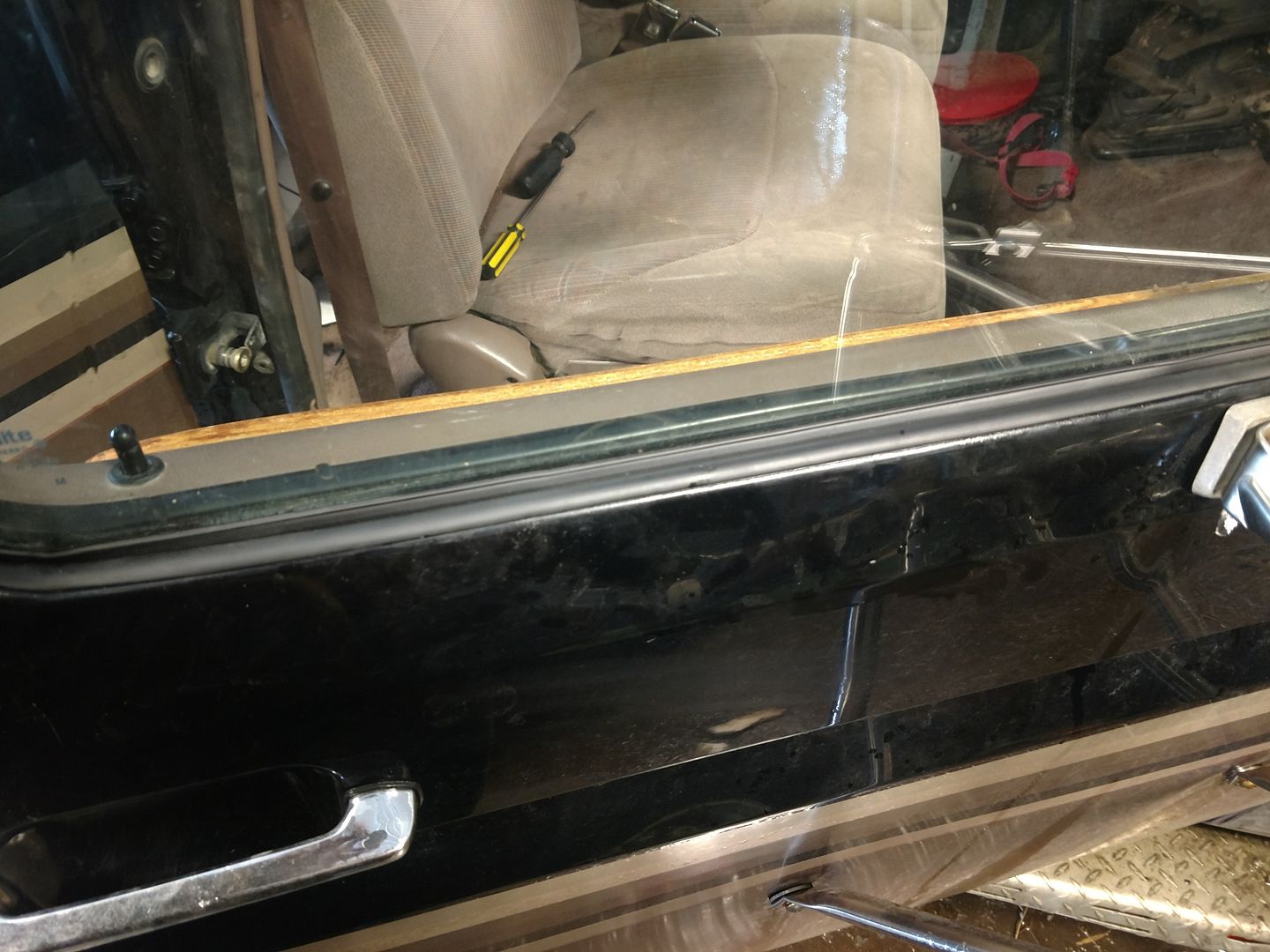

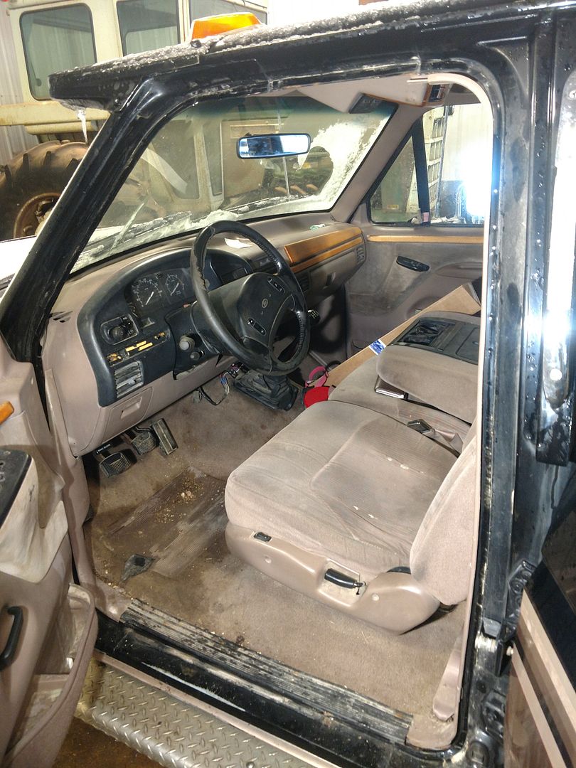

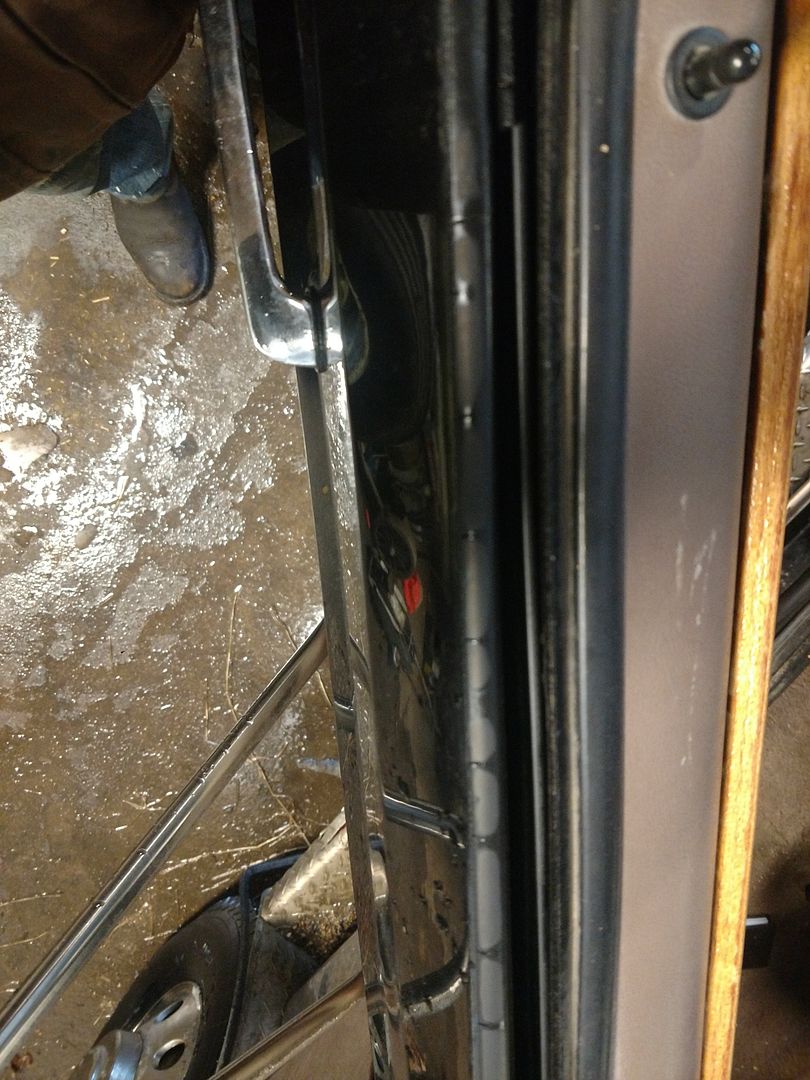

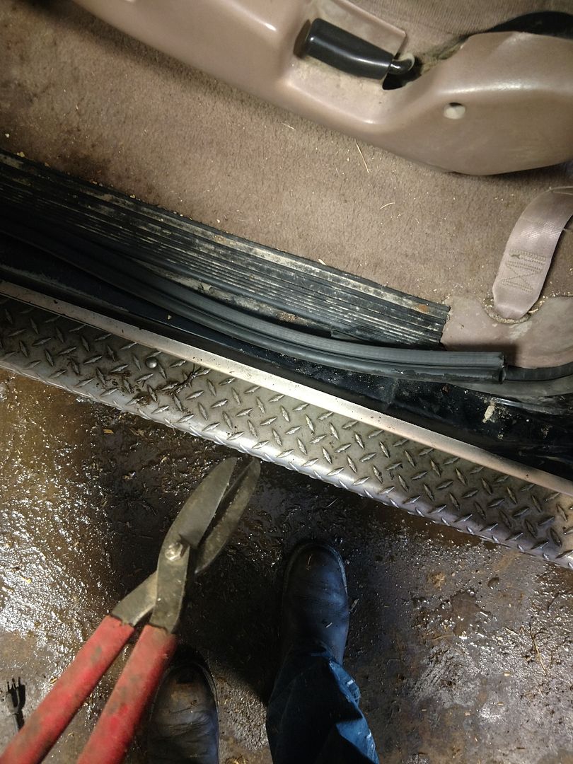

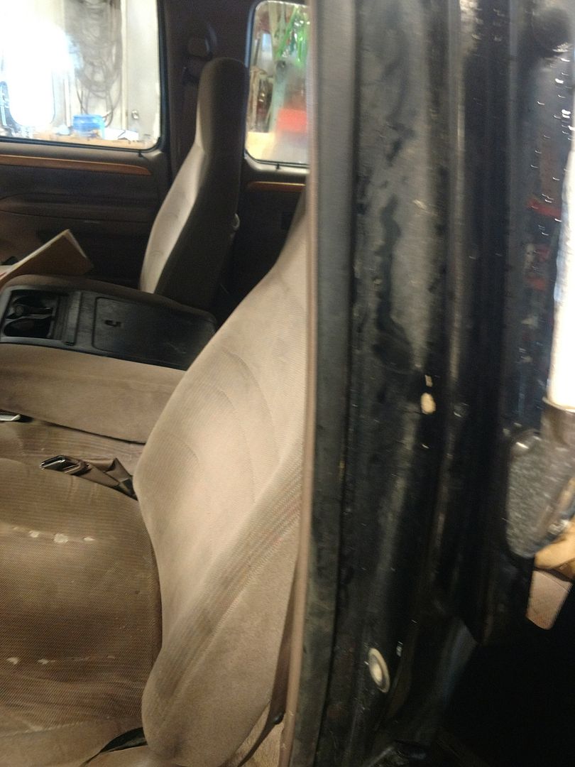

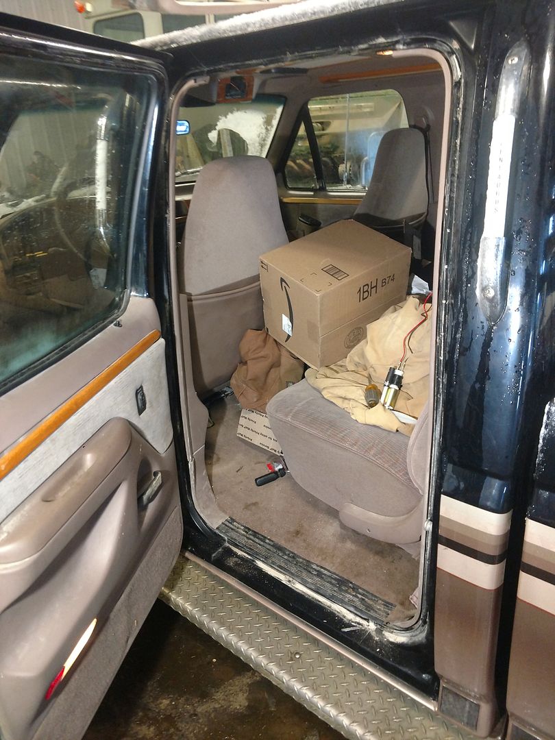

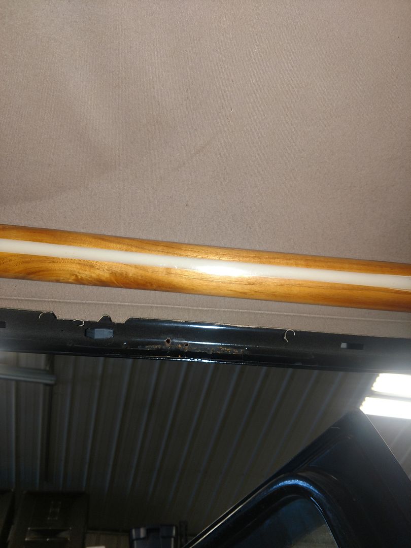

Got a few minutes to work on the truck today, decided to stuff the new doors seals in, must been doing something now takes some effort to get the doors to fully latch probably need to adjust the striker plates now, I ordered two of these door seal kits, they come each with 2 rolls of material, one roll is about perfect to do one door, just used a tin shears to cut to the correct length. I didn't get to in depth installing these, I removed the screws i could and removed the a pillar covers, the overhead liner pieces and it gave me enough freedom to pull back the rear pillar covers far enough to stuff the seal in and of course the kick floor board covers only half the screws came out but I was able to get enough room to stuff the seal in there too.
Also I ordered new wiper seals for the windows, for some reason they only offered them for the front windows, luckily my rear window seals are in pretty good shape, im not sure why just the fronts were rotted and gone

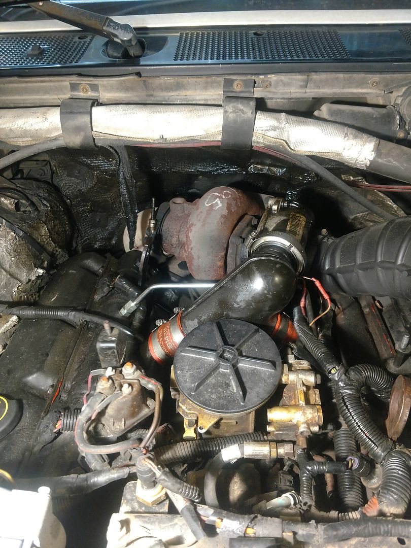

That firewall is filthy. Is that from the previous engine swap? Maybe check your uppies and make sure they are not leaking. It almost looks like oil sprayed on it. And yeah, those HP crossovers are not necessary. If you change or reseal the HPOP, take out the two check valves.....does the same thing but a little better. Keep an eye on that crossover line for leaks. My one time I did it, it never stopped oozing from the heads. I took it off and gave it away.
Im still trying to decide whats going on there, i need to wash it all off now and start fresh its been greasy since day one for me, i did have a pretty significant fuel leak from the filter minder sensor which i eliminated, all that fuel blowing back orginally had me convinced my turbo seals were pushing oil since thats where it pooled and dripped off the Y boot but since that delete i have no longer noticed a drip from the turbo, truck is surprisingly pretty drip free for a 7.3, power steering pump leaks which sounds like a common issue, ive been putting it off as i read there is a better pump swap out there just haven't researched it much or sourced out parts for the conversion, saginaw pump i think is what i read about
https://www.offroadxtreme.com/engine...-fix-and-more/
The easiest thing to do, and what I've done in the past, is just take a can of brake cleaner and start spraying all that firewall. It's just metal heat shield material and it will clean right off and then you can sort of start from there and see if you do have any leaks. Nice work so far.

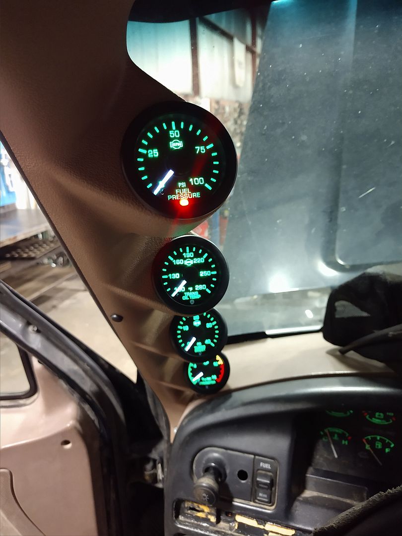

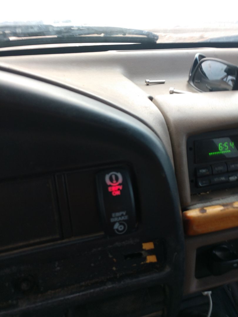

Got my gauge pillar painted and installed today, ISSPRO EV2 gauges, probably add a column mount yet for HPOP or something not sure, I didnt hook anything up yet as I didnt have a fitting to tie in the boost sensor, not sure my plans yet with the tranny but it for sure needs and output seal if not rebuilt also didnt want to drain and fill just to do it again in a couple months, same with the trans coolers, egt i just didnt feel like doing same with fuel pressure but they are installed and programmed just need hooked up so thats half the battle

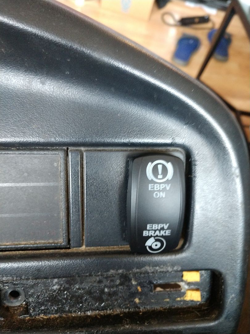

also got my EBPV switch installed and partially wired, i could not find the wire mentioned in the article for the high mount stop light but i do have the constant power hooked up so thats better then nothing just have to run a second wire when i get a chance

I did wonder, being as i deleted my filter life sensor and thats already 1/8th NPT if that is a suitable place to read fuel pressure from
I am pretty sure that should work...or the plug where the check valve is. Withe one should be fine.
