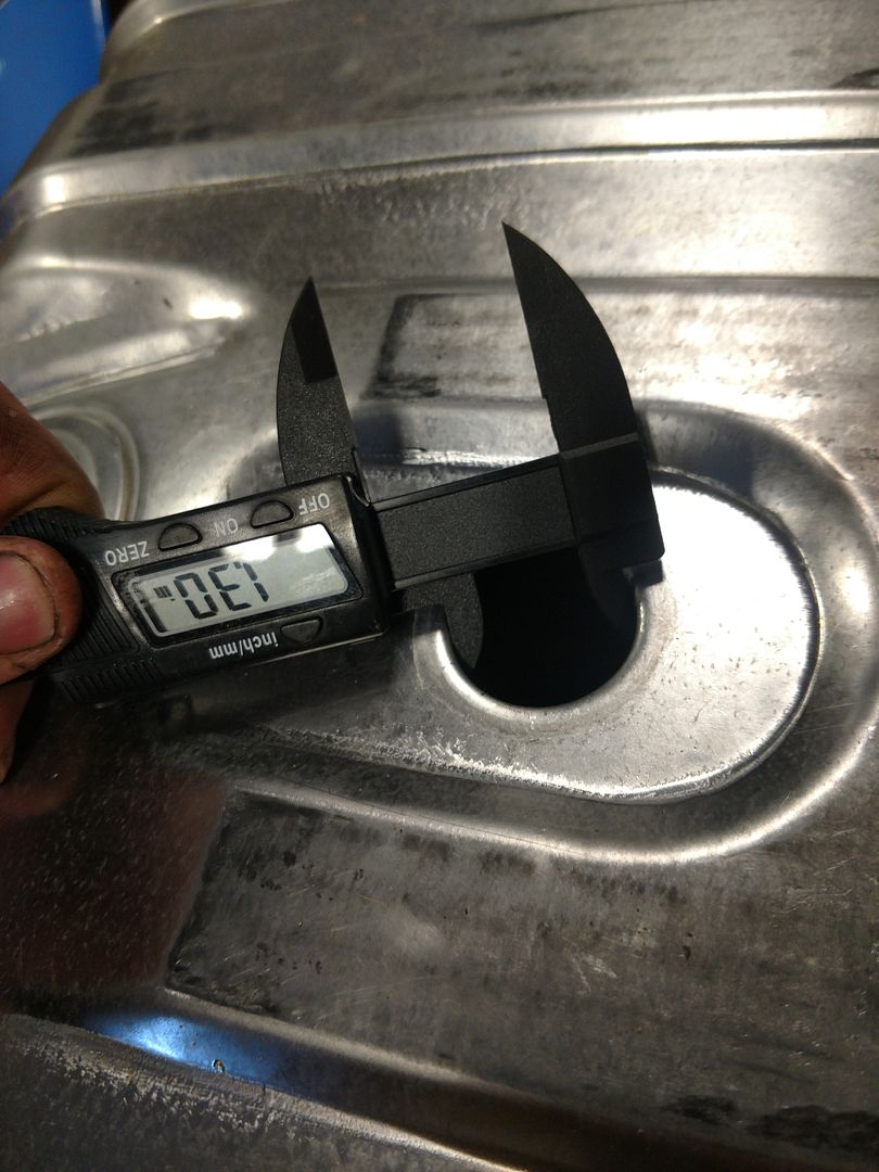

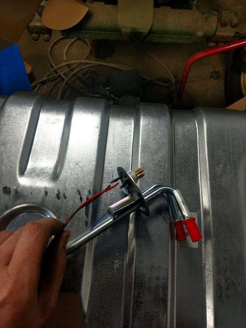

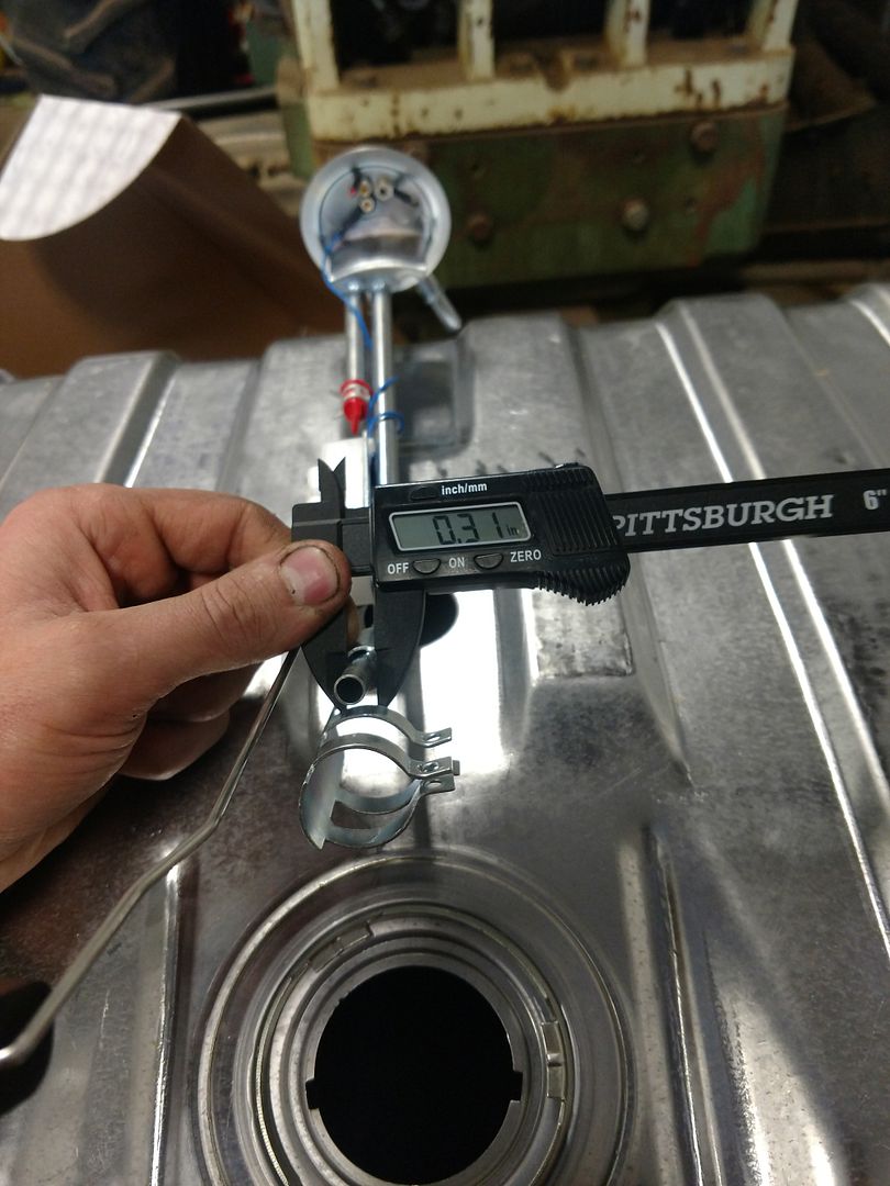

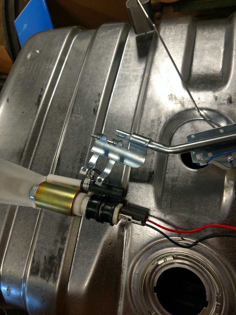

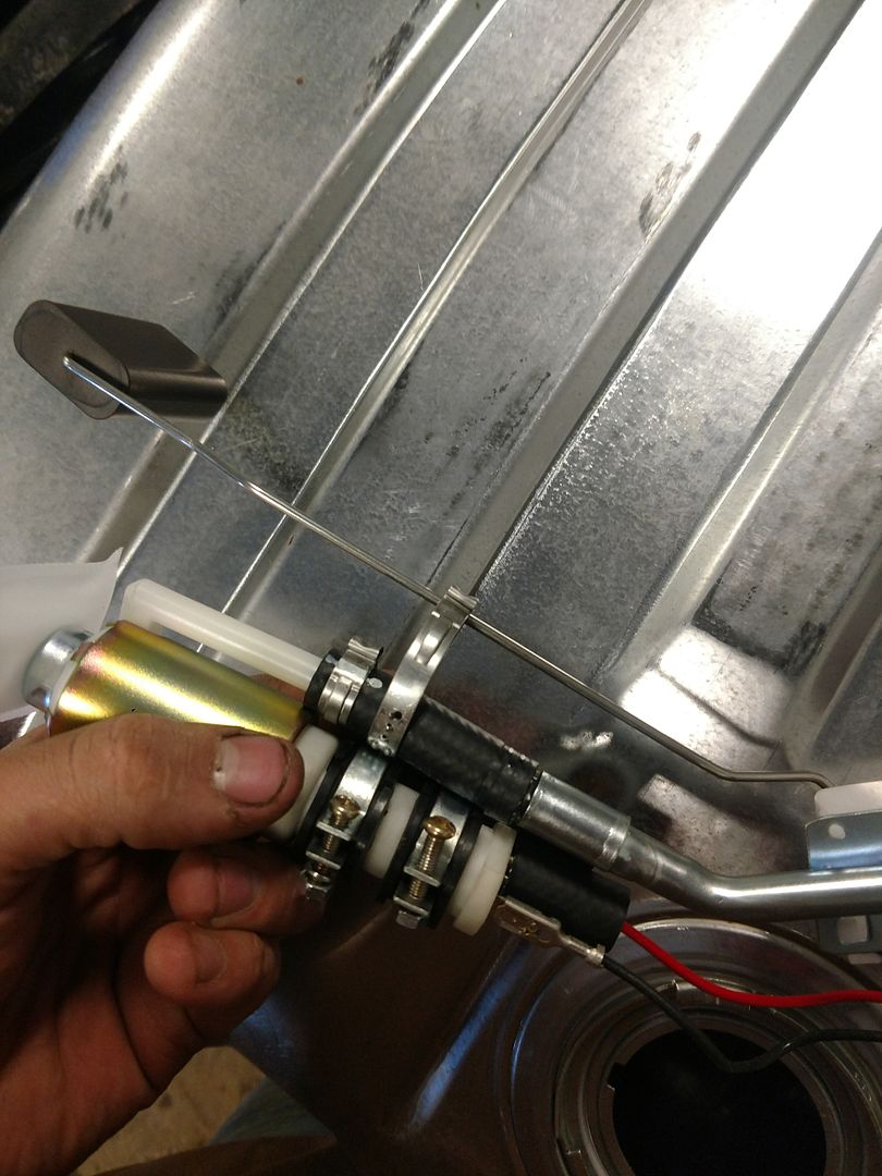

Took a peek over my fuel tank and stuff this afternoon opened everything up to get an idea for the parts ill need, what I order was a "kit" from rockauto (part# KIT0354 for 89 351 bronco i searched under) so i wouldn't be guessing on the pump/sending unit side i knew the sending unit assembly would fit the tank and the rest i could work around. I unboxed it all much to my surprise it wasn't near what I was expecting. The pump was rather compact and the return just dumps at the top of the tube with a little nipple/baffle.
I clipped the red and black wires for the pump, removed the squeeze clamp on the fuel line and loosened the two clamps holding the pump and pulled it off, might cut the bracket off later but its no bothering anything at the moment. The hose is 5/16" so just need some hard line to extend that to the bottom, I was debating installing a small well to help with low fuel conditions but I decided with separate fuel tanks one being over 30 gallons I have no excuse for being that low on fuel haha
some more measuring i found the filler neck nipple is 2 1/4" versus what i could measure on the truck appears to be only 2" so ill need to build that adapter yet also, or find a 2 1/4" filler neck
last but not least it appears the roller valve is 1.3" or 33mm? not sure on the hole in the stock tank so i guess that'll be one surprise when i get that far unless i order one for the bronco and go with it

You do know, 89 gas tank pump is a lift pump, not a pressure pump, right?
That is the last year for the 3 pump system for gas. 90 was first year fof high pressure pump In the tank
Also, there is no check valve on that set up to keep the fuel from returning into that tank if being pumped from the other tank

he is playing with a 96 diesel Charlie.
converting a bronco 33 gallon gas tank to work in place of the rear diesel tank.
part of the modification is replacing the in tank e-pump with a piece of hose and strainer foot.

Roll over valve stays the same all Ford tanks 80-97
Sorry for confusion. After Tom pointed out what going on I researched, and see the gas lift pump is exactly what you want.
Not sure where to get a set of the recall check valves, but that would be a good thing to have on there.
