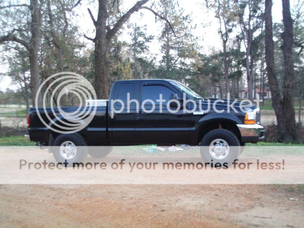

Its an oil base paste that you rub on and off just like wax it clean up any impurities and when you apply the wax it holds the polish and shine alot longer.
To be honest its like rubbing on crayon lol but it does wonders you wouldnt believe the shine it holds but i wouldnt try it unless you have time cause it requires alot of rubbing. ill get you some more info tomorrow on it.
This is a pic two days after with it sitting out side note the paint job is less than a year old but the truck has never been buffed or anything so it has a little haze to it. And the pics are poor quality.
