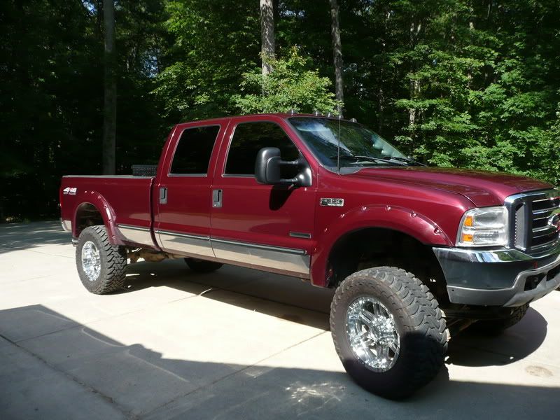

I have been thinking about this for the last couple years, and now I am kinda stuck in a dilemma. Where I have been living our neighbor was nice enough to come plow the snow out of our driveway. Now that I am moving, I no longer have this option. It wouldn't be a problem, but the girlfriend drives a car, and this driveway is longer. She leaves for work at 6am and I don't want her to be getting stuck trying to get up the driveway. Since I could also plow my parents house out, and possibly pick up side work plowing, I can justify the cost, but I have very limited knowledge on plows.
I have been told that I could add one to my 99 which is lifted. 3" body with a leveling kit(shackle) in the front, running 37" Toyo MT's. I am skeptical because the fact my frame sits higher than stock and running the 37's.
So has anyone else added a plow to a lifted truck or know if its possible? If so is there anything different I have to do? Heres a picture of truck for reference.

Ya i don't know about that, i had a 3" lift on my last truck and had to run 33" tires instead of my 35" because the pitch of the plow was all wrong and wouldn't cut through the snow. My mount was all the way down. You could build your own mount on your truck or just lower the one you buy but i couldn't because i just bought a brand new boss v plow and warranty didn't cover that . I would try to find a old truck with a plow already i know there are a lot around here right now. That way you don't tear up your truck

You should have the sector and angle cylinders parallel to the ground when the plow is on the ground. Whatever you have to do to the original plow frame to accomplish this. If you lengthen the truck mounted frame to get it level then make up new braces from the bottom of the dropped mount to reinforce them from bending.

The best thing would be to run a set of stock height or 285 tires for the winter. A leveling kit is fine for most plows. If you cant do another set of tires the best option would be to find a Western uni mount blade. The truck frame design is one of the easiest to lower. If you cant find the truck side you buy a new Ultra mount frame and the adapter that goes with it to convert the ultra mount truck side to a uni mount plow. I have used one of these with the mounts flipped on a truck as high as yours. It looks kind of funny but it will work.

Yep, it is possible. Seen it done many times, as mentioned you may need to do some modifying to lower the truck side bracket.
I've seen 8" lift with stock tires plow in this fashion.

You can run whatever height truck you want and don't have to change the truck side. On the fisher at least, there are 3 holes for different height trucks. For a lifted truck, all you have to do is custom make a bracket with the holes higher and weld it on. We have done that for my level'd dump truck and a lifted 250. Plow frame sits nice and level just as it would a stock height truck.
