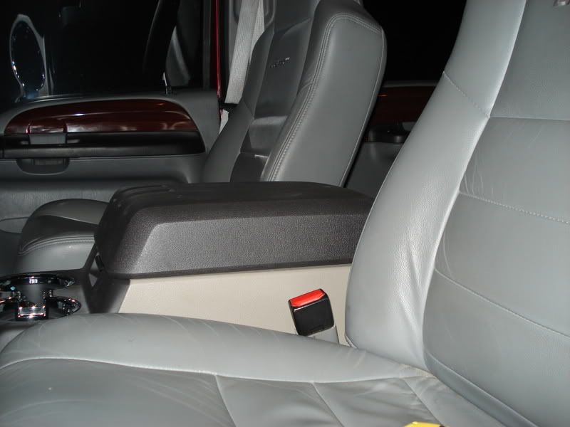

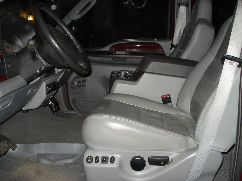

I have used this Graphite Interior Paint Aerosol 12 oz Net I have used it on fiberglass pieces to match the lower dash, as well as my overhead gauge pod and center console.
Here is a before/after shot for the console to see the differences
At first it doesn't look quite like its gonna match but when it dries up its pretty much a perfect match, plus they have all the other colors you could need.
