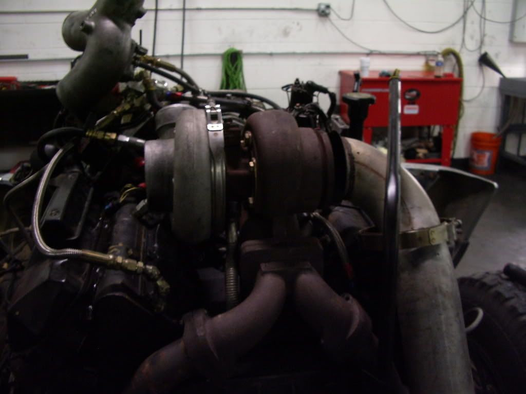

Got some more stuff for the truck; 355cc hybrids, BFH 76mm turbo, arp head studs, comp 910's, hardened pushrods.

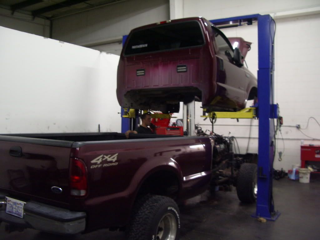

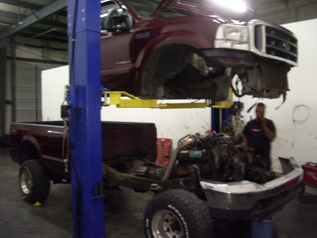

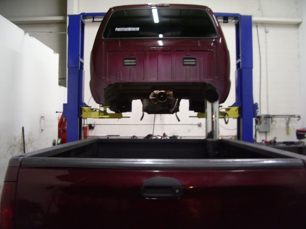

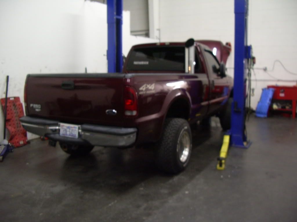

Decided to lift the cab for everything.....mainly for the studs and valvesprings. The cab on a 7.3 is cake compared to the 6.0. It really wasnt that bad. We had the cab lifted off the frame in a little over a hour. Already had the injectors pulled out before we started so it made it a little easier. We started kinda late so all we did was install the turbo. Studs, springs, injectors, PR's will go in tommorow.
Here are some pics.

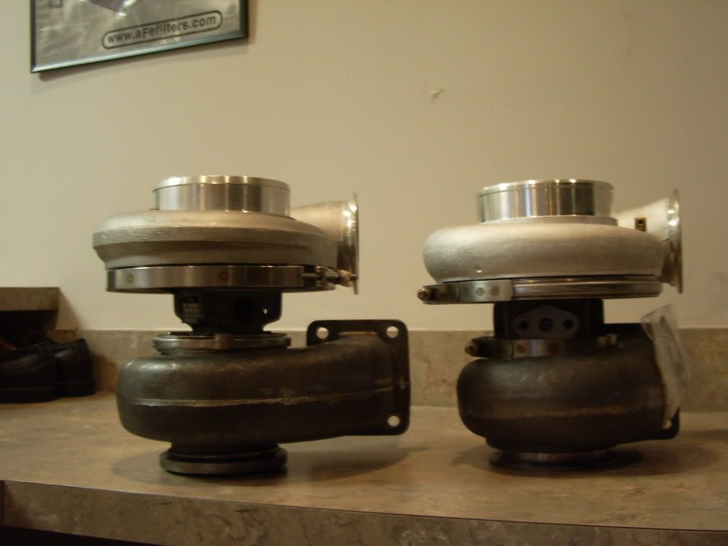

BFH

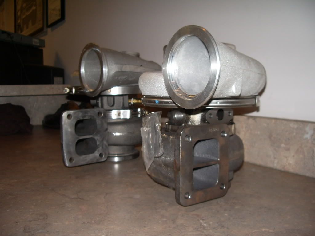

BFH (3.0 Ind) on left and a GT42R (2.8 Ind) on Right
Right Before we started working
Cab Off

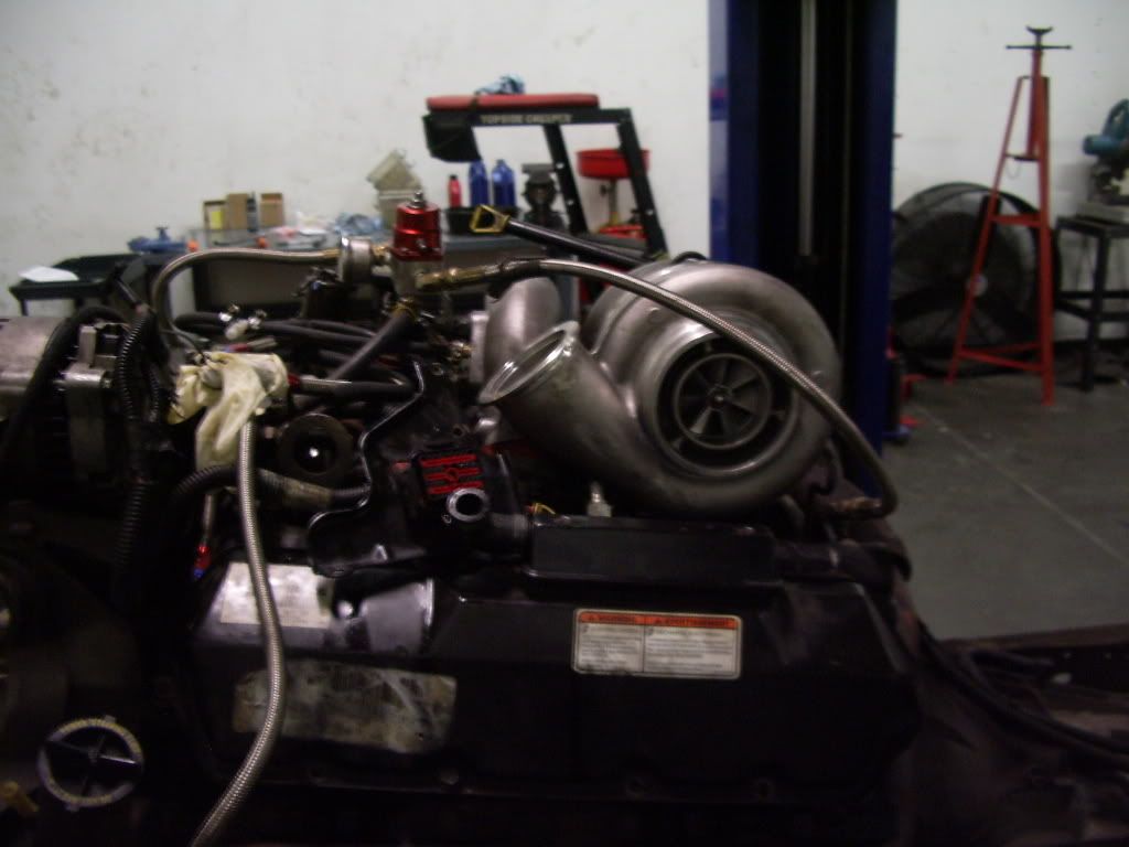

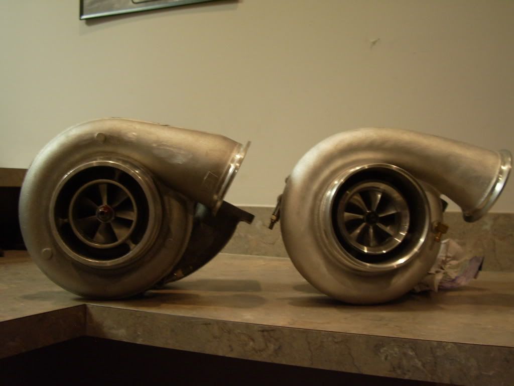

Stock H2e

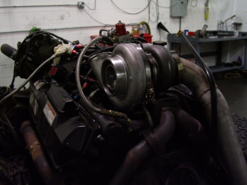

Stock H2e Vs. Swamps "BFH"
New Turbo Installed
Special Thanks to Twisted Diesel for letting me use there shop, tools, and expertise. Those guys are great. Also would like to thank Swamps Diesel for there awesome products.

Ive got a 76mm S400 sitting here that's going back in with the new motor, youre going to like it. Just based on the sound of it at 5-10psi, it sounds like it moves a s-load of air, just the tone of it. Wait till it hits 60psi and you're off. Good luck with that bottom end.
Are the injectors stock on the oil side, or are they modified?
Stock

Well, much easier with that lift I bet. HOW would you go about lifting the cab if you didn't have one of those? MANPOWER? Then what, set it on heavy saw horses so the IC and RAD won't get tore up? Just wondering, sure looks like it makes the work a piece of cake after it's off!
*48* Jim T. 2011 F-350 Lariat, CC, LB, SRW. White Platinum Metallic Tricoat. Black leather seats, I probably wont have*PMS,, with this one, at least no major attacks of it!
JimTJr is offline
post #9 of 47 (permalink) Old 10-11-2008, 01:06 PM Thread Starter
10.61 @ 128 MPH
Powersmoker's Avatar
Location: Outer Banks, NC
Posts: 2,297
Send a message via AIM to Powersmoker
Re: Cab Off For New Mods w/ pics
I wouldnt do it unless you had a post lift. The cabs are just to heavy to lift like that. But yes, its cake once the cabs off.......just like working on an engine on a stand.

BTW that turbo is huge next to the H2E.......Cant wait to see her go....
Thinkin I may give swamps a call for the tunes....Will they right over mt TS chip ?
