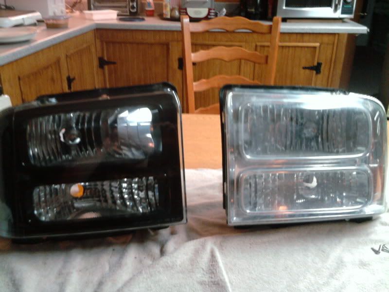

Stock on the right, DIY painted on the Left.

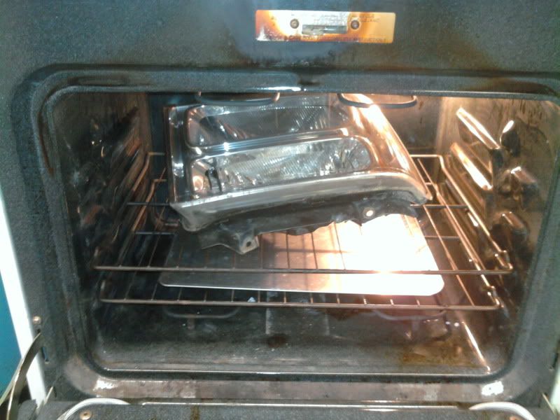

3: Preheat over to 265*(my oven has accurate temp reading so be sure yours is not off), also put a pan on the bottom rack, to prevent direct heat from the oven to hit the bottom of the headlight.

5: Put head light into the oven, and allow them to heat up for about 15 minutes.

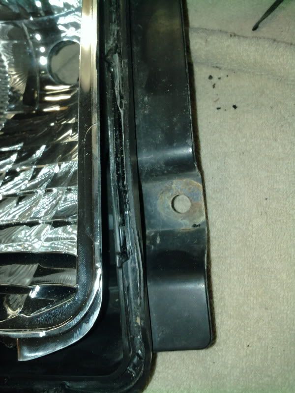

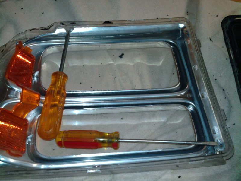

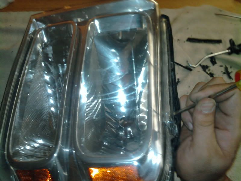

6: Slowly start to pry apart the head light. How I did this was first took a sharp tipped screwdriver and shoved it into the small crack between the lens and the plastic body of the headlight and slowly slid the screwdrive to sort of break the glue bond. Then I slowly gave it a little persuasion to help it start to separate. Prying very lightly and it will start to seperate. I had to put it in the oven a second and on one of the headlights a third time to get the lens to separate. After I got a little part lifted up, I pryed with my hands slowly, not trying to rip it off, but slowly getting the glue to release the lens.
7: Remove all the old glue from the headlight body and headlight lens. The glue may harden while you are trying to remove the old glue. If this happens, a few more minutes in the oven will get it back to something you can work with.

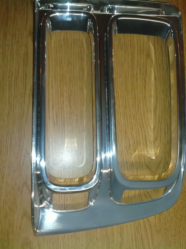

9: Take a scotchbrite pad and scuff the bezel so that the primer will stick. It should look similar to this...

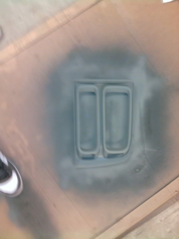

10: Spray primer on the bezel. I used two medium coats. Follow the directions on the cans for flash time and time to top coat. Then spray the color of your choice on the bezel. I used three light coats of gloss black. Also if you wanted to, you could tint the corner light(orange reflector). To do this, I used VHT lens tint in the rattle can. I used 2 very light coats on it, and it appears to have a good shine through.

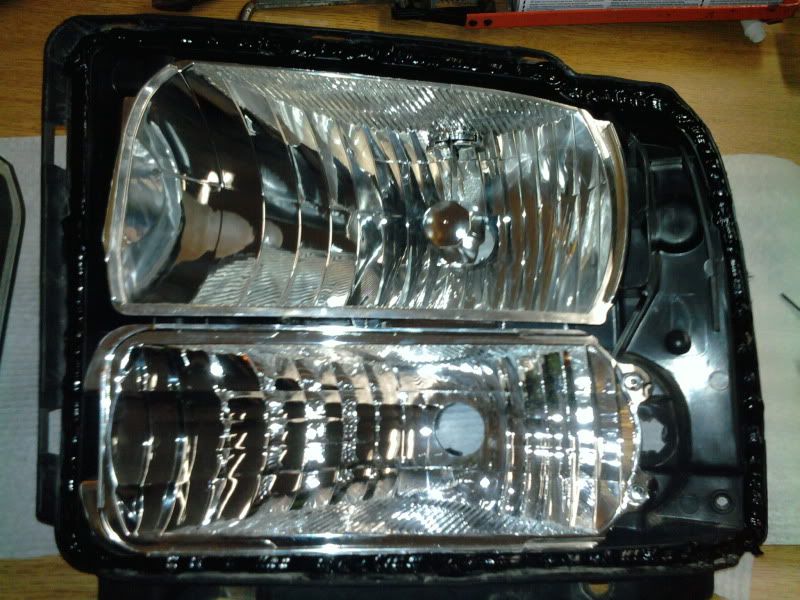

13. To reglue the lens to the headlight body, I used urethane. I'm not 100% sure on what they used from the factory, but it seemed like urethane, and I trust urethane to do the job. I just went out and bought a tube of windshield glue(which is urethane). In the groove you cleaned out all the glue out of, apply a nice amount of urethane. I used a little over 1/2 of a full tube of urethane to do both headlights.
14. Reinstall the lens back onto the headlight body, being careful to apply it correctly the first time to insure it will have a good seal. Reinstall the screw that holds the bezel/lens assembly to the headlight body.
15. Clean up any excessive urethane that may have pressed out when you installed the lens. The urethane is extremely messy sh!t, be careful to not get any onto your hands and then tough anything. You will pay hell to try to remove the mess up urethane.
16. Reinstall headlight bulbs, and reinstall headlights. Then enjoy your results.
