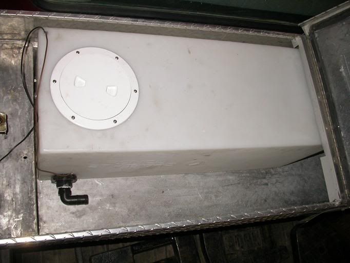

finally got everything put together and made my first hook with this setup this weekend.
I bought the cooler from a local diesel performance shop (gilmore performance) then basicly made everything else.
I am useing a 20gal poly water tank that came with out any holes and I installed the fittings and pump where I wanted them. the pump is a rule 1000gph pump and I ran 1 in lines to the cooler

Thanks, the truck dose seem to run stronger with the new cooler, but I'll know for sure after I get some more hooks on it.
before that pull I put about 10 gal of water in and 40lbs of ice with no salt. I'll probably buy 60lbs of ice before the next pull
