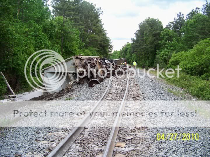

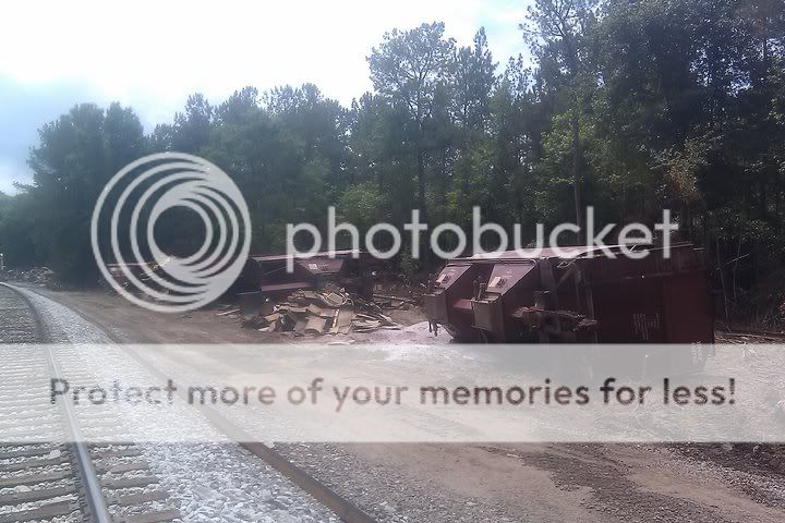

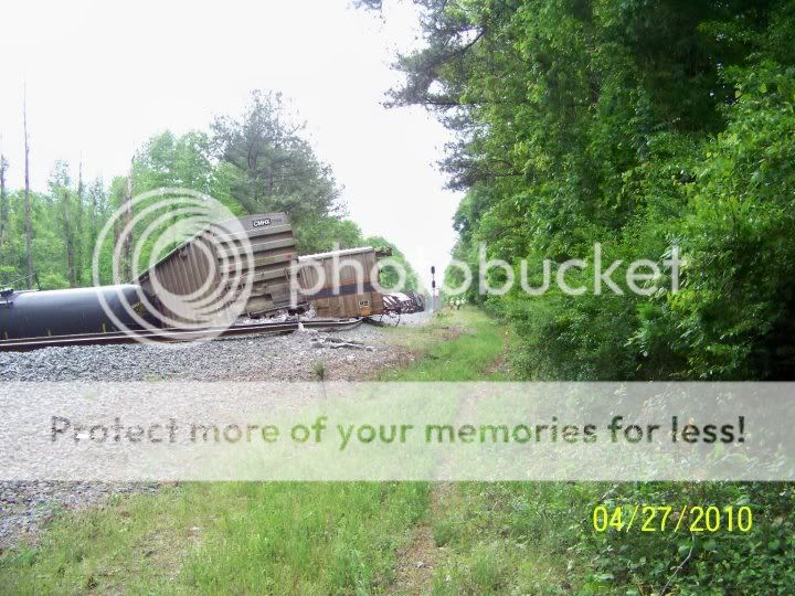

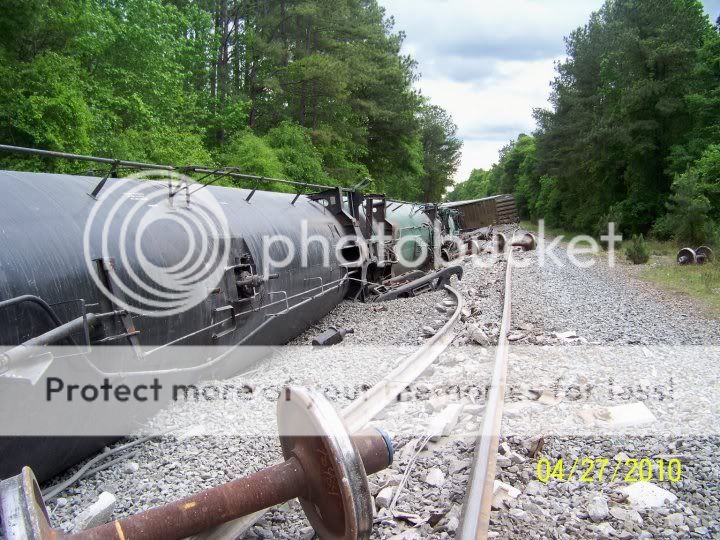

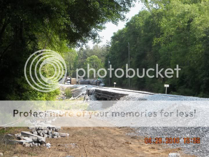

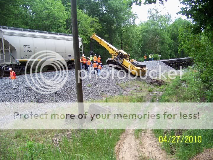

so this is the train tracks that go through my property and of course all the damage is right in the middle of my property so still awaiting a meeting to see what i get for compensation for letting them tear up my property and my roads and tearing down alot of my pines luckly it wasnt to close to my house! Enjoy

I guess that your property is in Ideal, Georgia, right? I live in Fitzgerald, Georgia and work for CSX Railroad. I ride trains on that same rail almost every day. I recognized the carnage from your pics. The cause of the derailment was that the rails spread too wide and the railcars actually fell in between. I'm very surprised that the engines didn't derail too. I was on a train that derailed four autoracks filled with brand new Nissans just north of Manchester, Georgia about two years ago. What a mess! CSX is self-insured and all the autos are shredded for salvage. They will not even sell a tire off of the autos. They don't want to be held liable later on down the road. Anyway you WILL be getting a very nice chunk of money for all the damage and mess on your property. Good luck!
From the photo's, it looks like that stretch had concrete ties. Unless there was a stretch of wood ties where it actually derailed............it's not real likely that wide gage was the cause.
Without knowing any info, my first thought (given the time of year and concrete ties) on the cause...............would be a track buckle due to warm weather.

The official reason for the derailment was that the rails spread too wide. The distance between the inside of the ball(top) of the rail is 4 feet 8 inches plus or minus 1/2 inch. Yes concrete ties were being used but the rails spread anyway. I know the engineer that was operating the train very well. As the engines were going across this particular piece of track the crew (engineer and conductor) noticed it was very rough and backed off on the throttle and was calling the dispatcher on the radio to inform him when the train went into emergency due to derailment. The train originated from Waycross, GA. and was heading to Manchester, GA. with this crew and then to Birmingham, AL. with a new crew. I am not guessing or assuming any of this it is all fact. I am a conductor myself and it's my job to know this info as well as all track conditions and info from Jacksonvile, FL. to Atlanta, GA. and everywhere in between.
I didn't mean to come across as questioning your veracity, as to what you were told was the cause. Sorry if you were offended.
It's just that I've been doing this for 34 years and all too often the "official" cause.........isn't the real cause. :shrug:
For the record, standard gage is 4' 8 1/2" (56 1/2"). You are allowed 1/2" less (56") and up to 1 1/2" wider (58") depending on class of track..........which is based on track speed.
The comment by the crew, that the track was "very rough" ...........just reinforces my opinion that the primary cause probably wasn't wide gage.
It's very difficult to "feel" wide gage from the loco.
If the track buckled (misalignment) under/just ahead of the train, then the crew would definitely feel that. They would also feel any surface anomalies (one rail higher than the other).
Either of these conditions can cause the lateral force of the wheels to roll (tip) the rail and cause the wheels to fall in. The aftermath would show that the wheels fell inside inside the gage but, the primary cause isn't wide gage. :shrug:
It's just very rare for a concrete tie section to develop wide gage, unless it is in a very sharp curve (which by the pic's, it wasn't).
Derailment investigation is a complex science that oftentimes requires equal parts; Investigation, measurements and intuition.......... based on experience.

I'm guessing you've never seen something like this then either (1st pic). The mainline is between the two sets of equipment and was actually cleaned just a couple of hours previously.
We also used ballast regulators, outfitted with special snow plows/wings when possible (2nd & 3rd pic).
