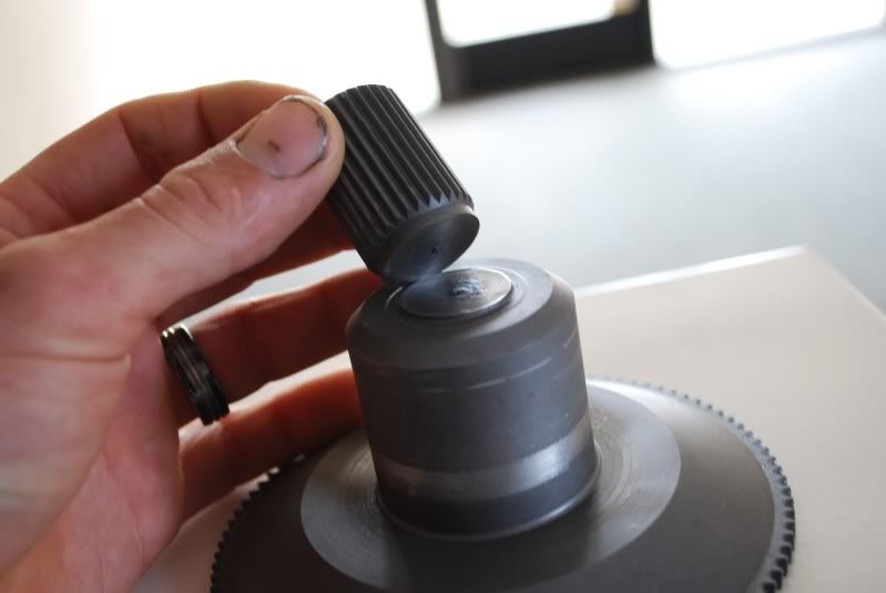

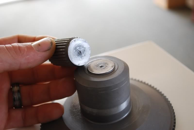

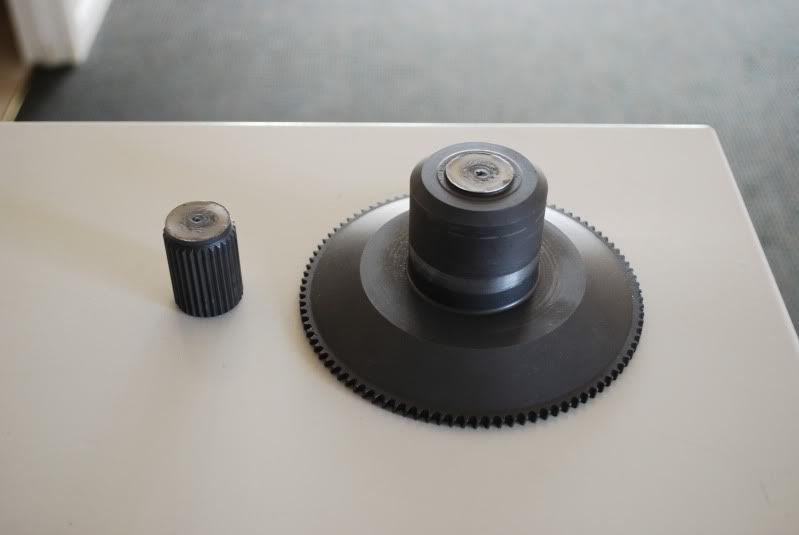

Well, this was about the biggest waste of money I have spend on the truck. It lasted exactly two WOT shifts and then broke. Spartan 310 owns this thing!
At least I was able to get two paper weights out of it. Only $412.40 each! :doh:
Suncoast does not manufacture the part. I am seeing and hearing on the forums is that with transmission tuning they are making the transmission shift too hard. I have seen this with other transmissions as well. The factory intermediate shaft seems to be a pretty good shaft, but it also may have some torsional give to it as well. If you make the transmission shift too hard, you will break parts. There is a difference between making the transmission shift well (firm and crisp) and making it bang into gear.
