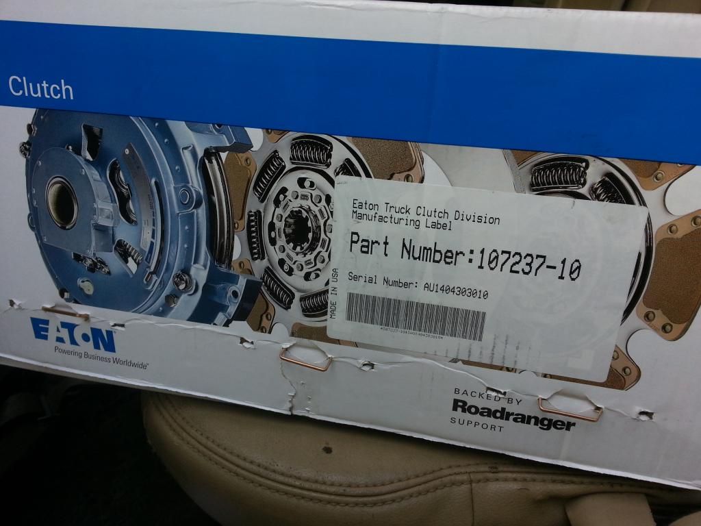

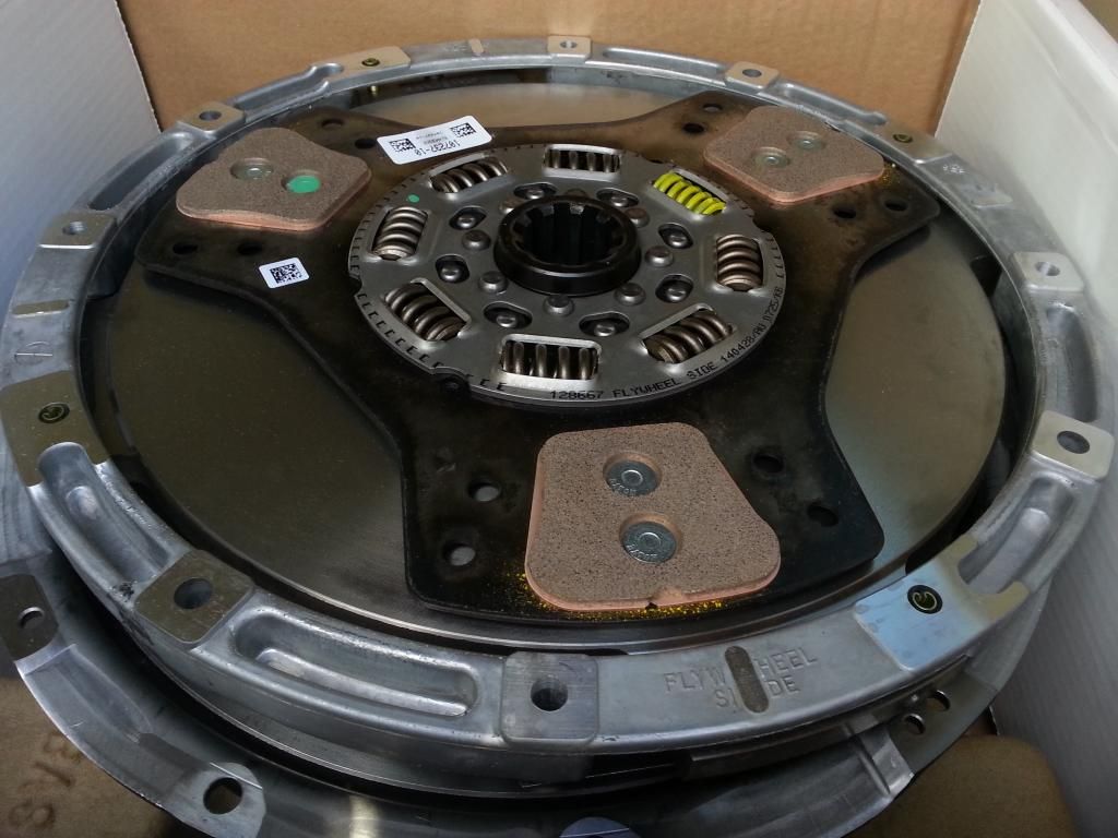

I didn't want to use an auto that might fail next, or spend $5-7000 building a tranny, so I've decided to stay medium duty. I picked up an International reNEWed Spicer ESO66-7b 7 speed tranny for $1500.
