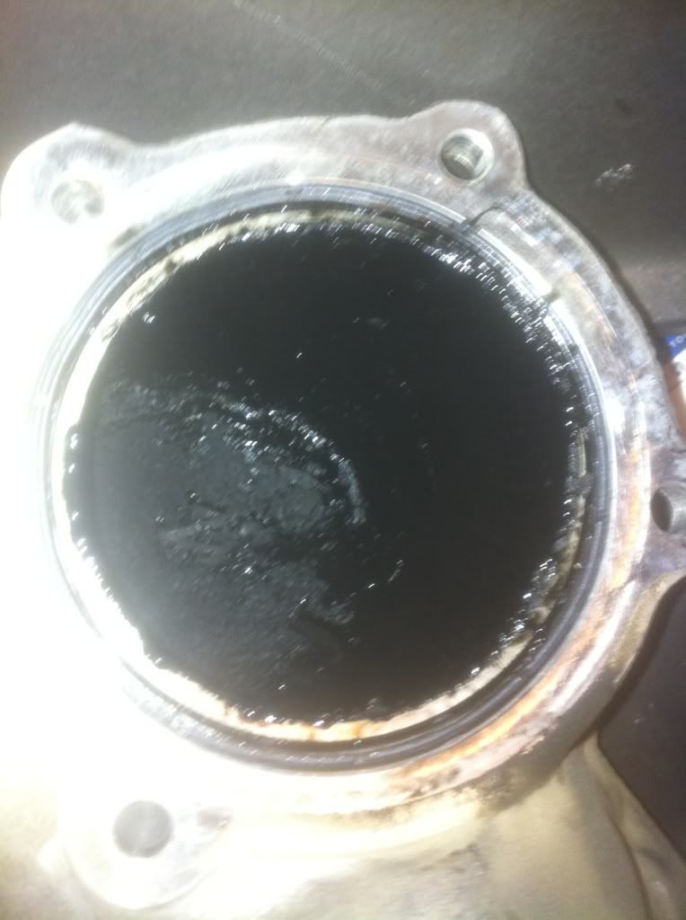

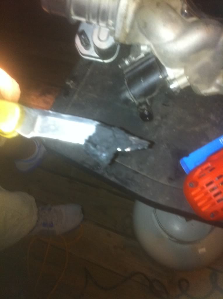

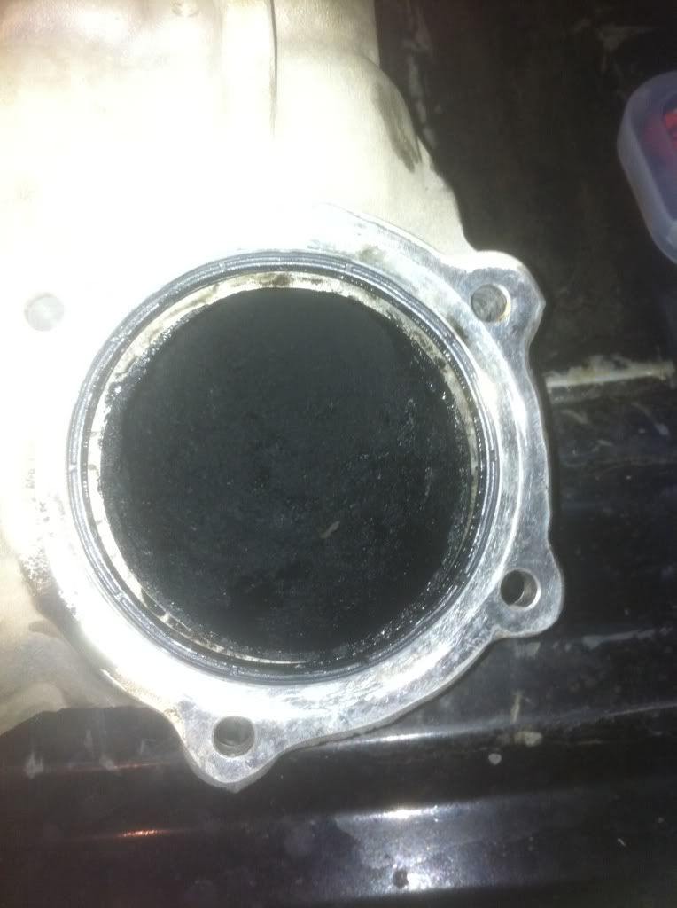

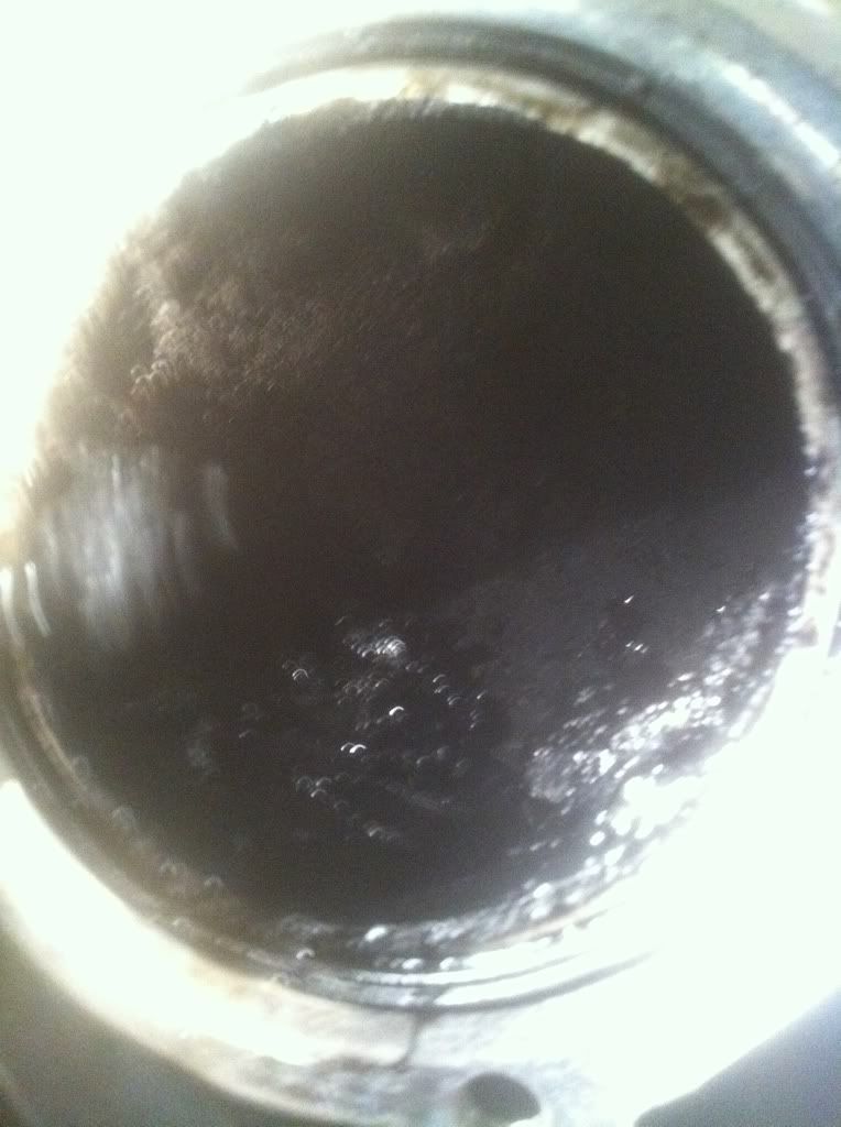

Here are a few pics of my intake manafold. In some places there is about an inch of crap ranging from stuff like caked on charcol to tar. Deleting my egr will be my next mod. There is about a 1/4 inch built up in the egr its self.

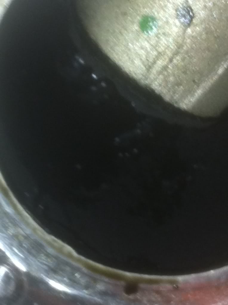

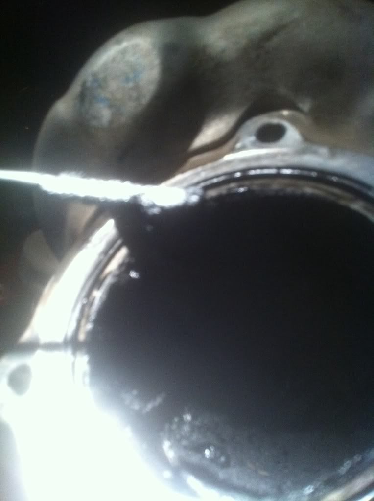

I couldn't get all out. Just scrapped what I could out and wiped out where I could reach. It was bad as far as I could see with a flashlight but I couldn't get to it

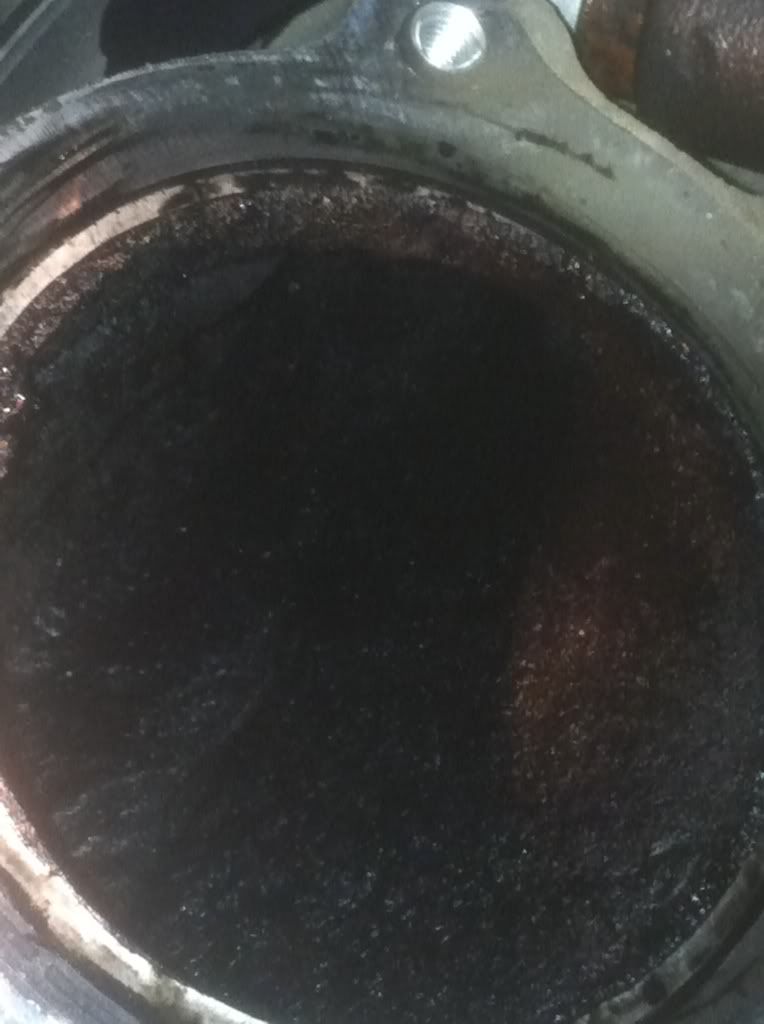

I cleaned one for a buddy by soaking it mineral spirits then sprayed it out with carb clean. The parts washer we did it in was brand new and had about a 1/4" of muck in the bottom of it when we got done! Pull all sensors first though.....of course! Looked new when we got done. No more egr either.

the combo of soot from the egr and oil from the crank case vent makes one good mixture... Glad I have none of the above. After some miles without the egr and the CCV mod. My intake seems to be cleaning itself.

I can see most of it being soft, but what about when a chunk comes out and falls into a cylinder. believe me, just because ford does it, doesn't mean its good for the truck. I have personal friends that are techs. they cringe about some of the things they have to do to satisfy ford. my intake is totally clean for the most part after about 7k with no egr and CCV modded.
Can't you just drizzle seafoam down the intake while the engine is running. Let it sit for 30 min or so then go run the piss out of the truck? Works on gassers. There is also one hell of a fog fest when you do it the first time.
WOW yours cleaned up in 7k!!! That is great news. My truck has 80k on it and i installed an egr delete, cold side pipe, cfm+ and CCV so mine should clean up to. I planned on taking that manifold off when i do head studs...
my truck only had 30k, 25k tuned, and a lot with tunes that shut down the egr. So it was not that bad. It will never be clean, but there is not a build up anymore
